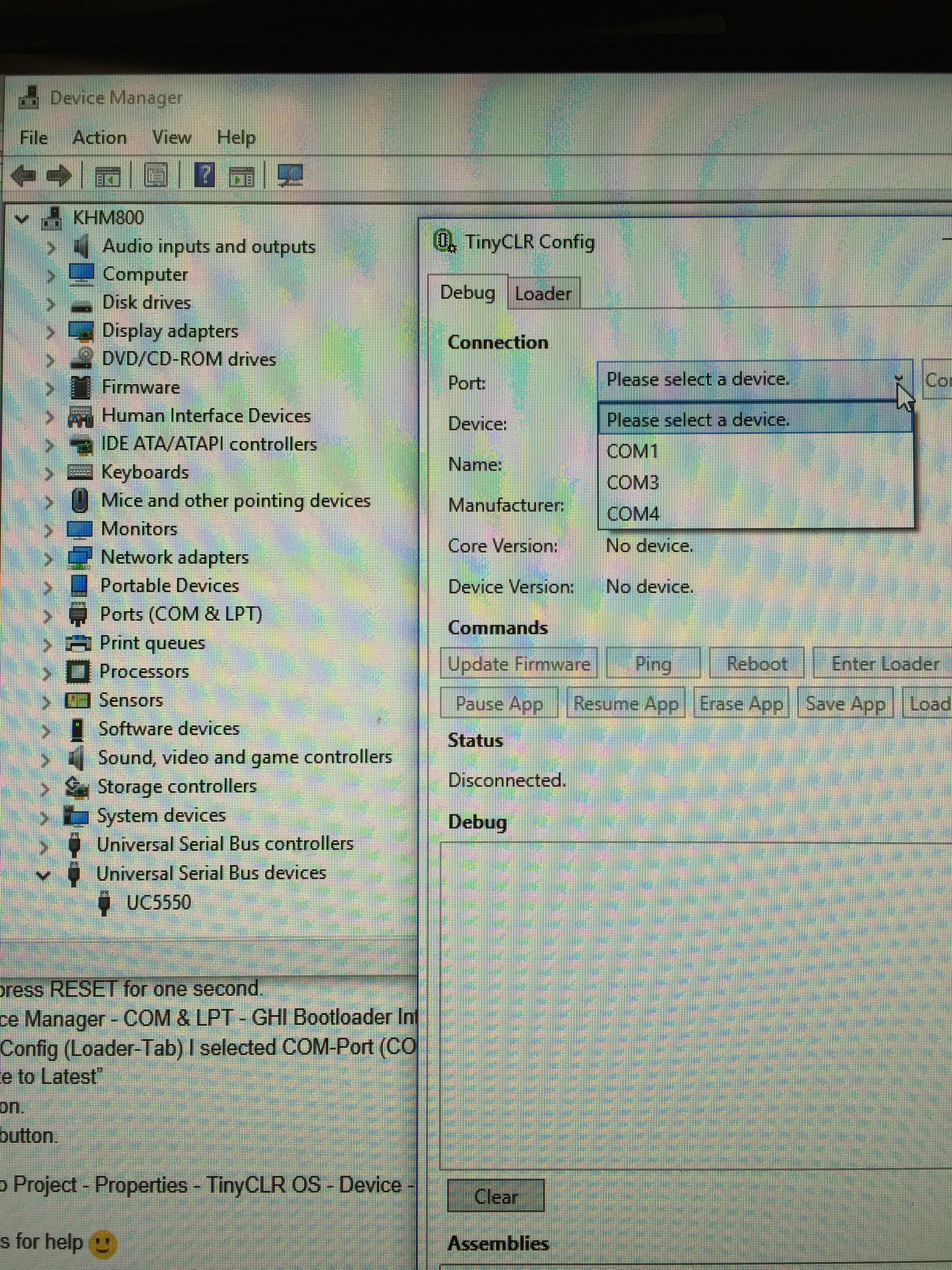

The new TinyCLR Preview 3 cannot list my UC5550 while Win10 Device Manager shows the USB device UC5550. Please see the attached picture.
I also tried setting the UC5550 into DFU mode ( press SYS A and RESET buttons) and plugged my PC’s USB cable to UART A port on UCM Dev Board. Going back to TinyCLR and I found the new virtual serial port can be listed in the Combo box of Port and I selected it. When I clicked the Connect button, the Rx led of UART A was flashing continuously. However, TinyCLR still cannot connect to the UC5550.

i took the image of Tinyclr Config in the screenshot as meaning that was what was desired, but Config app couldn’t see it
go ahead with the state that you see UC5550 under Device Manager, right click your mouse, uninstall UC5550 driver. If there is any box to check when right click to uninstall, check that box. Then hit reset button on the board.

When pressed the Connect button on TinyCLR Config, both Rx and Tx LEDs of UART A on UCM Dev Board are flashing continuously for a while. Eventually TinyCLR Config cannot receive any response and its status is “Connection Failed”. It appears that the latest TinyCLR Config is defective. I also tried all Preview version of TinyCLR Config but the results are same irresponsive.
