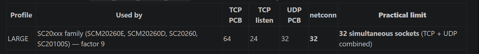

The LWIP stack has the following limits defined for each profile
Small:
MAX TCP Sockets - 5
MAX Listening TCP Connections - 5
MAX UDP Sockets - 4
Medium:
MAX TCP Sockets - 16
MAX Listening TCP Connections - 8
MAX UDP Sockets - 8
Large:
MAX TCP Sockets - 32
MAX Listening TCP Connections - 12
MAX UDP Sockets - 16
Of the active TCP Sockets only a subset of them can be listening sockets, but the total TCP sockets cannot exceed the profile limit. So for the large profile you can have up…
I don’t know if it was ever documented…
