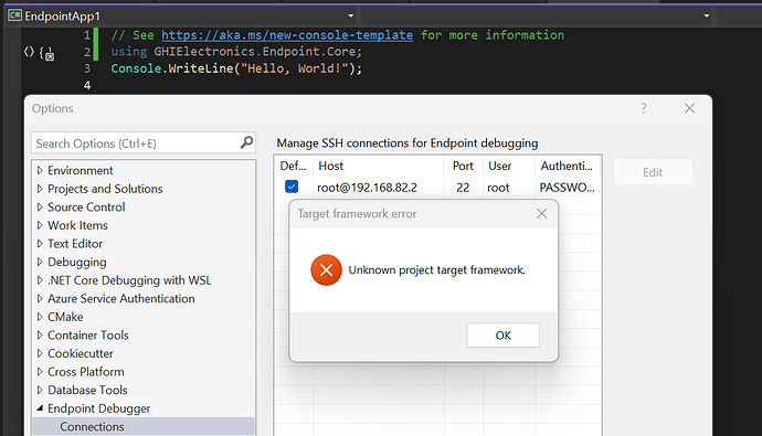

When I select first #1, I get the target framework error dialog directly.

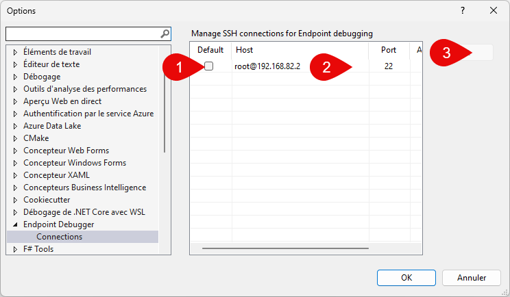

When I select line, then edit (and change nothing !), then click OK, I don’t have any dialog box, I can check checkbox without dialog error, but it don’t run from endpoint (and no json file is created in .vs folder).
When you click OK, it will check connection to the device, make sure the device is connected at that time.
Reset the board for sure, do not modify the line, just click check.

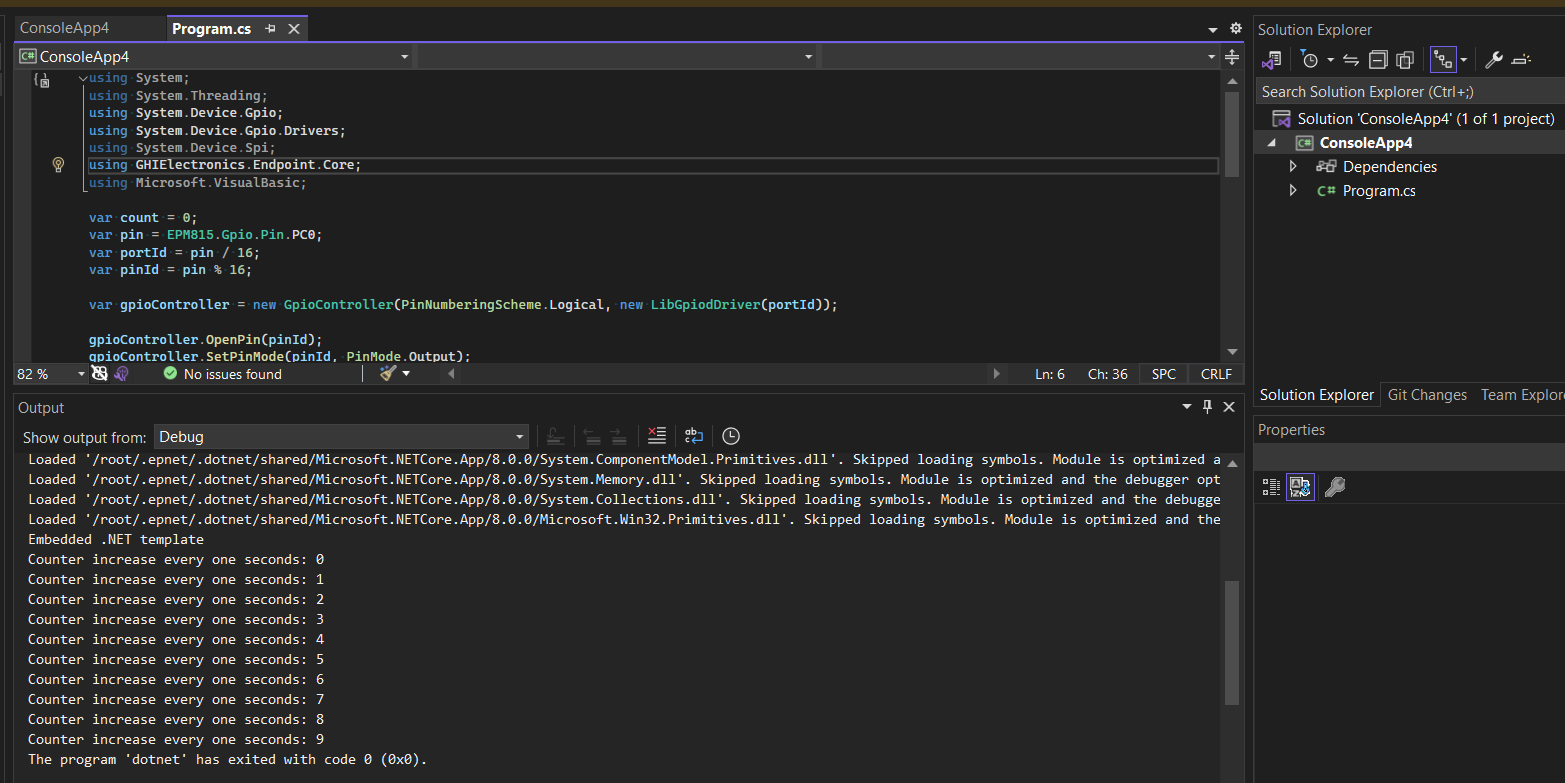

For me the 0.1.2.1 extension fixed the problem.

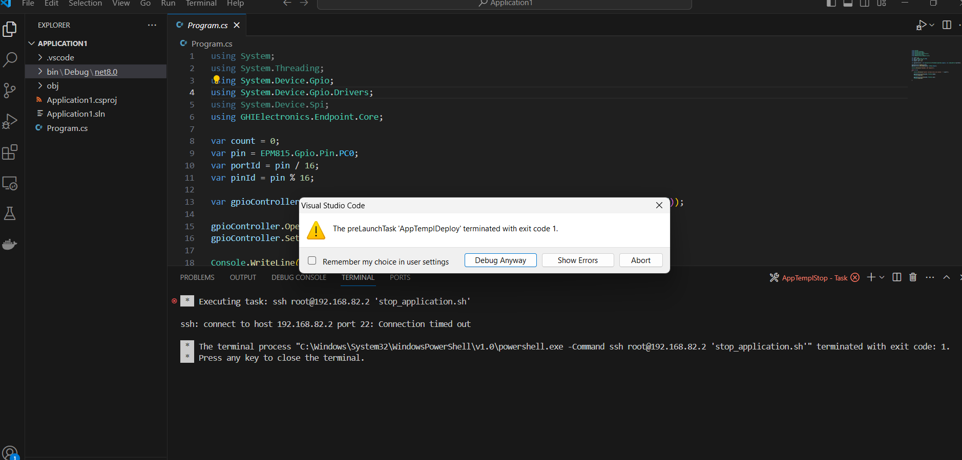

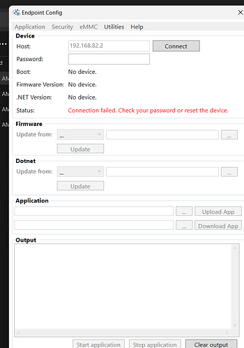

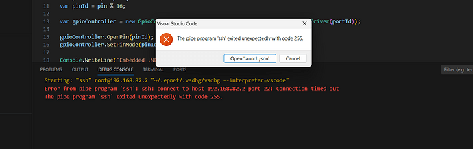

Hi Guys received today end point and when i tried to connect with config i received
I have Win11 Us English ,
Visual Studio 2022 Enterprise 2022 v17.9.2 ,
Visual Studio Code latest on

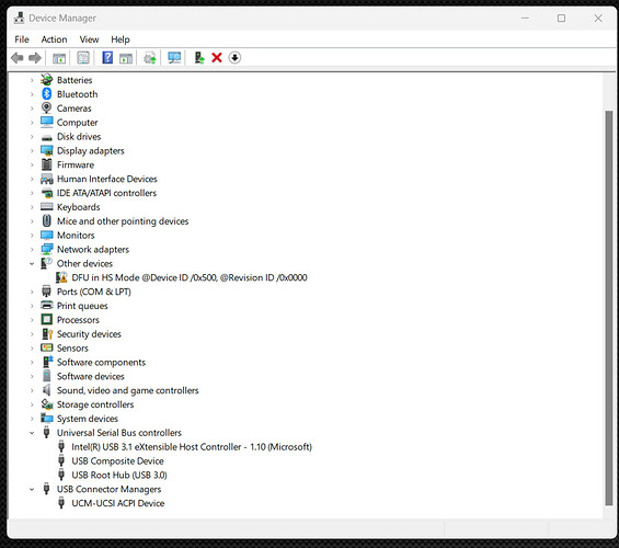

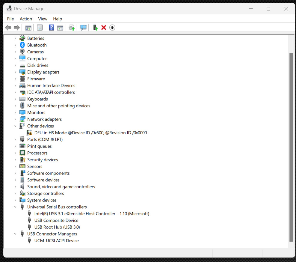

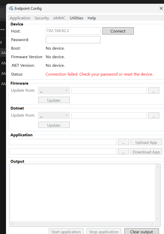

this result and in device manager it show

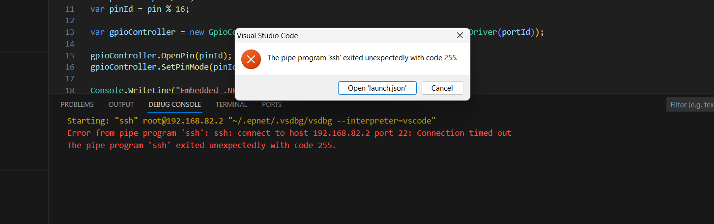

on VSCODE (based on instructions)
after certain time
now i catch documentation “seems my board is blank” and i need to burn on it image or i’m wrong ?
Have you put an sdcard on Endpoint with Endpoint OS on it: Downloads ?

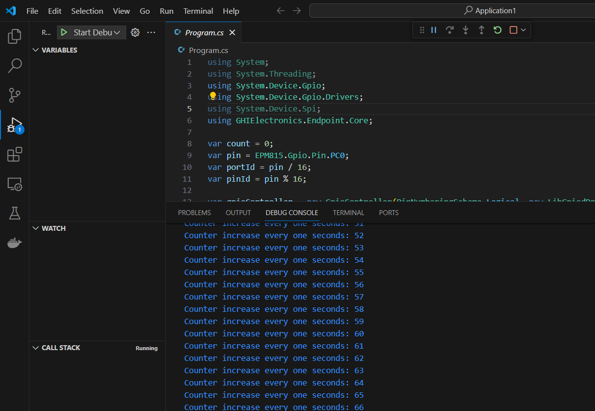

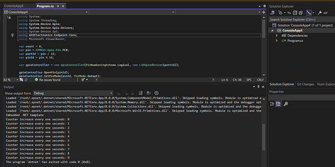

yes just downloaded and installed and tried first sample and work well via Visual Studio Code
also on Visual Studio work pretty well too
