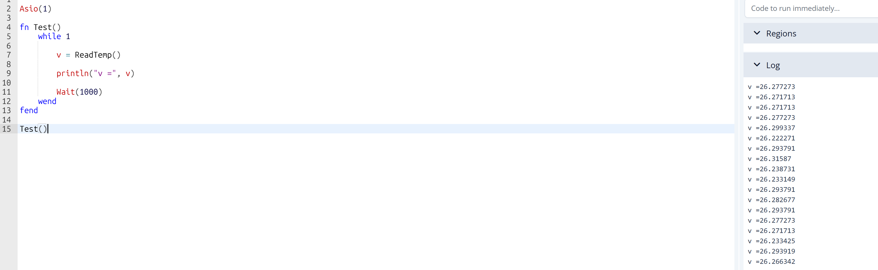

If you can run python, I think you can run Console as well, try this, from console.duelink.com, you should have same or similar what I have

Try console.duelink.com, paste code below:
Asio(1)
fn Test()
    while 1
        v = ReadTemp()
        println("v =", v)
        Wait(1000)
    wend
fend
Test()
it should not be zero
