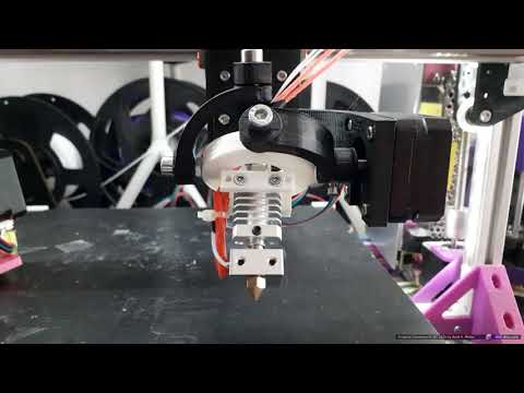

7 degrees? Any what would they be? X, Y, Z and …
Are you going to tilt the extruder?
**** Oooops…
Just saw the video. I guessed it right. ![]()
