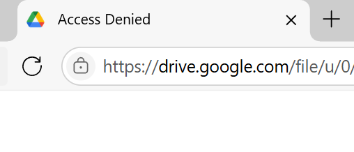

Somehow I can’t access the link, could you send the zip file to email?
Sorry. I send an email with the sample project via support GHI address.
Have you received it ?
My mail has been rejected. What is your email for this ?
Otherwise I change the permissions on my drive.
You can now download the .zip file.
we have it, you can delete the zip file now.

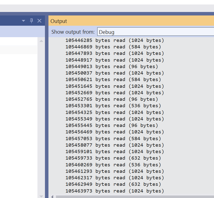

Hi, we were able to reproduce issue,
Seems to me, problem comes from Wifi module FW, we consider to check/upgrade the firmware on Wifi module but it will be long research: WiFi AP mode auto disconnect when read to fast · Issue #1385 · ghi-electronics/TinyCLR-Libraries · GitHub
For now, increase the speed to 12MHz or 16MHz will help this issue. I can upload few MB just fine with 12 or 16MHz. Higher speed (20 or 24MHz) will be failed.
ClockFrequency = 16000000,
Seems I can up more than 100MB without issue, using your code, just change to 16MHz
Very interesting. Thanks a lot for your analysis
Indeed increasing the speed to 12MHz or 16MHz is better and the issue doesn’t occur.
