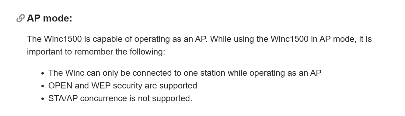

I think because the chip does not support at the time we develop wifi modules.
As quick look again, seems same result. In STA, it does support WPA/WPA2 as well but in AP, it does not.
This is from digikey:

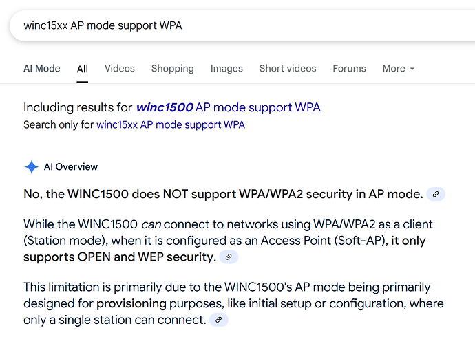

This is from AI:
Of course we don’t make decision bases on AI results but it is always good reference.
But, I am not surprised if latest firmware now supports WAP in AP mode, technology is updated every day,
