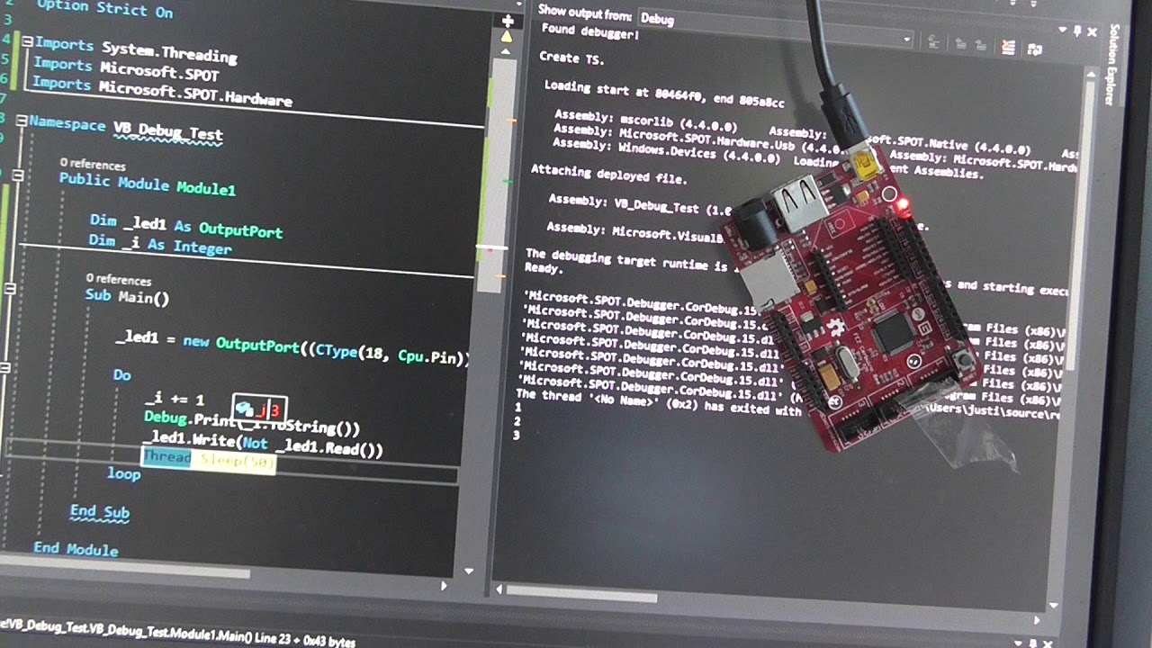

So heres the evidence… CerbuinoBee running a VB app with NETMF 4.4 in VS2017 with full debugging and no explosions…

The fix is in the debugger type system and I’ll post a PR to github shortly (once I clean up a harmless but ugly hack I used to get a quick fix out). GHI can then apply that same fix to their host-side debugger code. The github issue thread has more details on what the root cause was.
