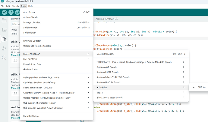

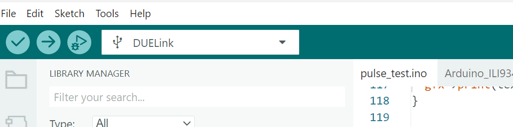

Arduino, you don’t need library, just need DUELink board manager
After installed DUELink board manager, select DUELink, likely below:
Then you should see something like this:
