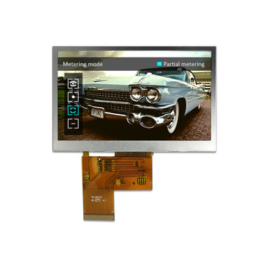

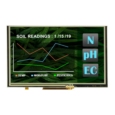

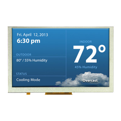

We have been working on this adapter board that allows users to connect Newhaven displays http://newhavendisplay.com/ to any Gadgeteer main board. See images for examples but note how the adapter board can also be mounted on the back of the LCD.
We are looking for feedback as we are trying to keep this as universal as possible.
These displays should be supported but this is still a prototype (7", 5", 4.3" with options of capacitive or resistive)
http://www.newhavendisplay.com/nhd70800480efatxvctp-p-6912.html
http://www.newhavendisplay.com/nhd70800480efatxv-p-6720.html
http://www.newhavendisplay.com/nhd70800480efatxlctp-p-6911.html
http://www.newhavendisplay.com/nhd70800480efatxl-p-6284.html
