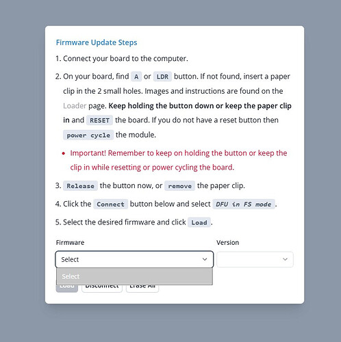

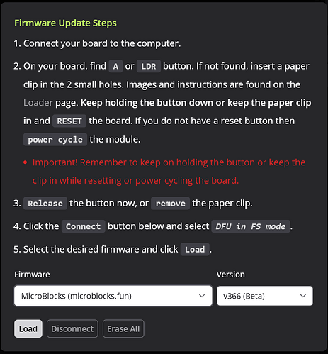

This is what you should see after you click connect. What do you see? Note at the bottom how there are options of what firmware to load.

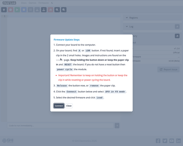

HI
here is what i see on ALL my computers after putting Ghizzy into DFU mode & Pressing connect- both Windows & Linux running Chromeβ¦β¦
No list from which to choose

Here you need to click connect button and select the DFU device. Then the list will show.
Please try and let me know what you see.
What I mean here is that the list will not show till you connect.

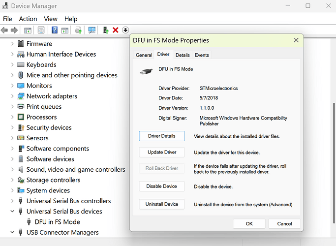

Could this be a driver issue? I am looking at device manager and this is what I see.
Can you please find the βDFU in FS Modeβ on your end and show us what you see when you double click it?

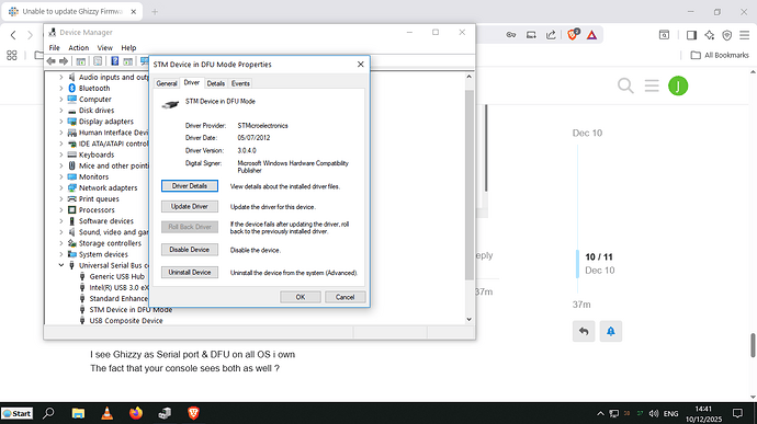

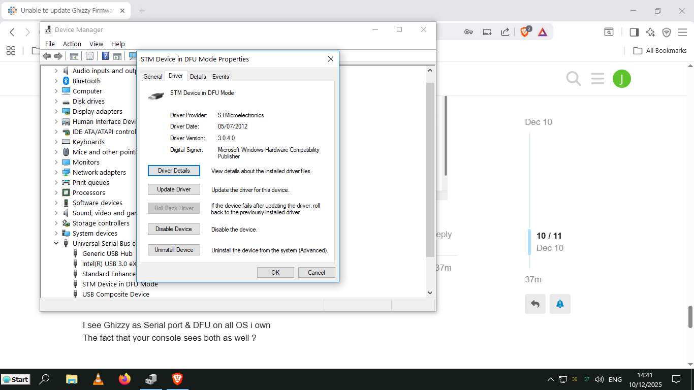

I see Ghizzy as Serial port & DFU on all OS i own
The fact that your console sees both as well ?
here is what i see on my Windows10 PC
Hope this helps
OK I am very confused. Your PC is seeing the device just fine!

seems your driver is 2012, which is very old.
We are using 2018
Hey Dat, the driver update worked. I DMed Jason and got it squared out.
