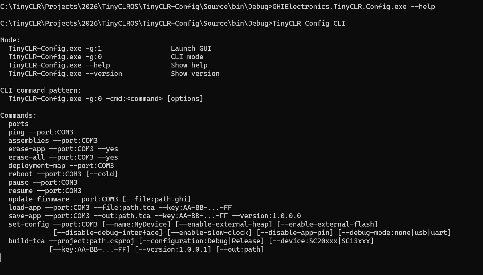

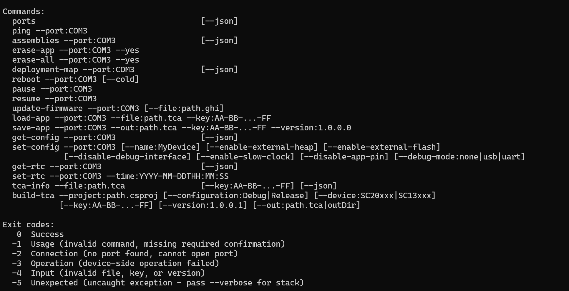

TinyCLR OS / Endpoint - CLI Deploy
Is there a way to deploy to devices from the command line using PowerShell?
Is there a hook from the GHI libraries that Visual Studio uses? I would like it if Claude code could test the hardware autonomously.
Well, I decompiled the library and fed it to Claude. It inspected the code and crafted powershell files to call the library to deploy from the command line..

We are going to make TinyCLR Config to be command line. Let me know what style do you want we will look in next release which will be released soon.
TinyCLRConfig.exe -p path_to_project -d sc20260 ….

  1. command line to streamline the deployment of an existing app in a production-type environment. This has been added to Github as an improvement.
  2. deployment for debugging while in Visual Studio. I believe this is somewhat of a new request since it involves closing the loop in the development cycle using an AI agent. Allow the agent, like Claude Code, to push the deployment and read the debug logs. At least that is my take on it. Maybe @Mr_John_Smith had something different in mind.
It can deploy but it can’t compile. I was also able to get it to listen to the debug output whilst interacting with the serial port to run tests on the system (serial on UART1).

Hey Dat, I’m really interested into using this solution to generate a tca application file without hardware connected (in our CI/CD pipeline).
Do you have a beta we can try?
No, not yet, but soon
Do these look good?
  • Exit codes — does each command return predictable non-zero on failure? Required for if ($LASTEXITCODE) { ... } in scripts.
  • --json outputports, assemblies, deployment-map, and a hypothetical get-config are way easier to consume as JSON than parsed stdout.
  • get-config / read-config — there’s a set-config but no inverse. Can’t audit what’s actually flashed.
  • tca-info --file:path.tca — inspect a .tca offline (version, key fingerprint, target SoC) without a device. Useful in release pipelines (verify the artifact before shipping).
  • set-clock / set-rtc — small but real
The clock thing is a nice to have but get-config and a way to validate the tca files prior to flashing would help.
They are done, include get/set rtc:
set-rtc is a really good features !
