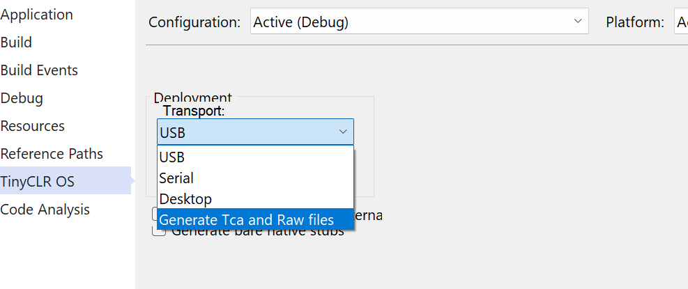

If we’re still taking requests, It would be nice to be able to create the .tca deployment files without needing a working board connected.
This feature has already been added. Please let me know what you’re not satisfied with.
Wait a minute, when did you add that?
Ok. How do I set the key?
create a file name tca.json same folder to your .csproj
file look like:
“AppKey”: “00-00-00-00-00-00-00-00-00-00-00-00-00-00-00-00”,
“AppVersion”: “1.0.0.0”
Replace by your key and version. The extension reads that file and do their task.
Long time ago :d
