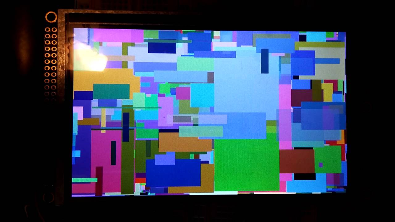

7in SPI using RA8875
RA8875 NETMF driver by @munderhill
