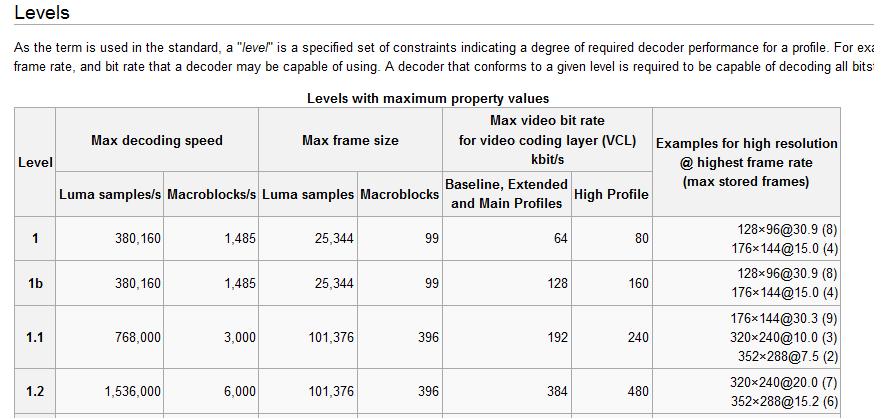

It is possible at this time ? (Spider or Hydra)
I mean somthing like

Skype or similar is using a PC architecture that has much different architecture than a Spider or Hydra. There’s umpteen support chips in a PC, specialised comms, and lots of bandwidth (relatively speaking). In contrast you have a simple processor with general IO connections that you’re able to use for a multitude of purposes, but they aren’t suited to every task, and high throughput and video isn’t one.

Encoding MPEG4 is very complex, even for a pc. There is a reason why some chips are specifically made for this.
