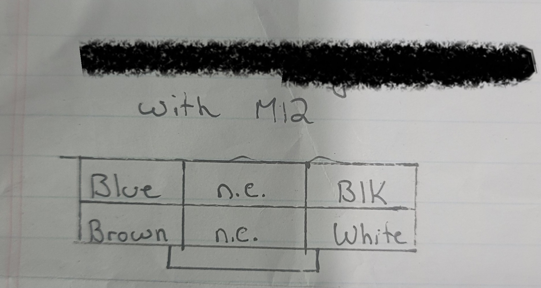

Antropic just released Claude Design. It is a graphics design tool. I needed to document a cable design.
I gave it this image to start:

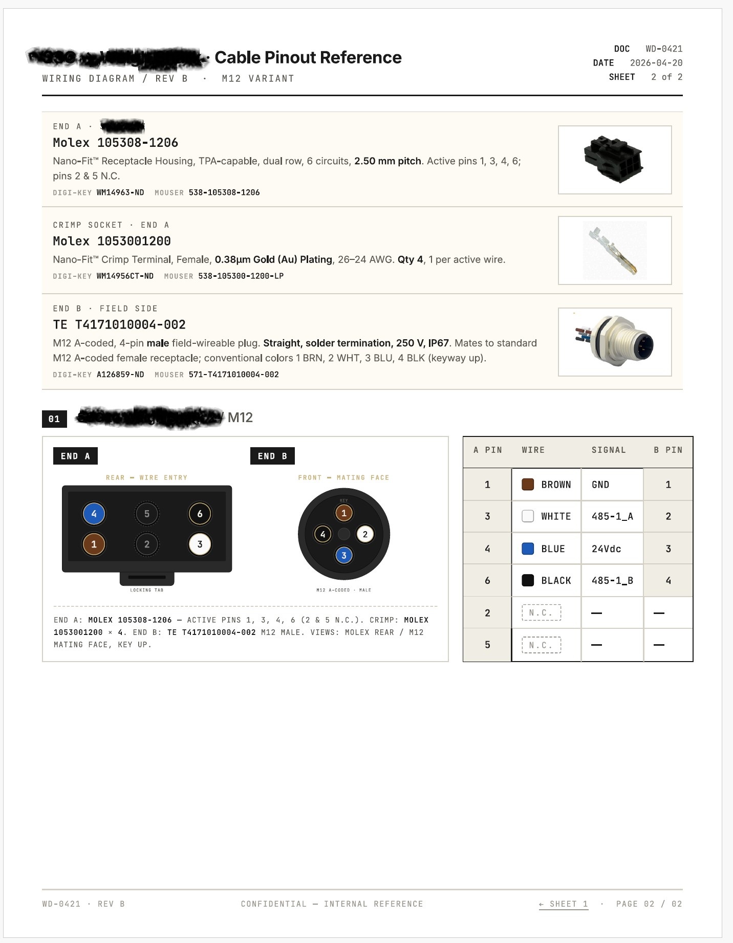

I gave it the part numbers for the connectors and the images of the connectors. Signal values for each color, and with some additional prompting, it returned this.
If you use it, be careful. It blows through tokens like crazy. It consumes tokens at a pace best described as “enthusiastic.” They are billed separately from regular Claude usage. It is still in the preview phase, so I am sure the pricing will change. I will say, though, it is well worth it.
This is something that I have never thought of! Really nice.
Best description of a token eating rate, ever.
