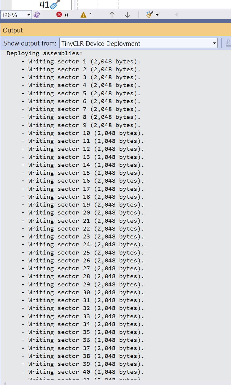

The issue is back, but it might be in a different form.
It seems like hitting deploy in visual studio activates the action twice. My output window is showing information about the device deployment DLLs, switches to writing sectors, then halfway thorugh switches back to device deployment DLLs and then back to writing sectors (which skips halfs the sectors this time). Most of the time, this results in a failed deployment with a crashed visual studio instance. Sometimes, deployment starts but the code executes much slower than usual. Using a breakpoint and every line of code takes between 1s and 5s…
Any reason the action is activated double?

	- Checking status: sector 22, address @0x08051800...
	- Writing sector 22: Ignored (same crc)
	- Writing sector 23: Ignored (same crc)
	- Writing sector 24: Ignored (same crc)
	- Writing sector 25: Ignored (same crc)
	- Writing sector 26: Ignored (same crc)
	- Writing sector 27: Ignored (same crc)
	- Writing sector 28: Ignored (same crc)
	- Writing sector 29: Ignored (same crc)
	- Writing sector 30: Ignored (same crc)
	- Writing sector 31: Ignored (same crc)
	- Writing sector 32: Ignored (same crc)
	- Writing sector 33: Ignored (same crc)
	- Writing sector 34: Ignored (same crc)
	- Checking status: sector 35, address @0x08058000...
	- Writing sector 35: Ignored (same crc)
	- Writing sector 36: Ignored (same crc)
	- Writing sector 37: Ignored (same crc)
	- Writing sector 38: Ignored (same crc)
	- Writing sector 39: Ignored (same crc)
	- Writing sector 40: Ignored (same crc)
	- Writing sector 41: Ignored (same crc)
	- Writing sector 42: Ignored (same crc)
	- Writing sector 43: Ignored (same crc)
	- Writing sector 44: Ignored (same crc)
	- Writing sector 45: Ignored (same crc)
	- Writing sector 46: Ignored (same crc)
	- Writing sector 47: Ignored (same crc)
	- Writing sector 48: Ignored (same crc)
	- Writing sector 49: Ignored (same crc)
	- Writing sector 50: Ignored (same crc)
	- Writing sector 51: Ignored (same crc)
	- Writing sector 52: Ignored (same crc)
	- Writing sector 53: Ignored (same crc)
	- Writing sector 54: Ignored (same crc)
	- Writing sector 55: Ignored (same crc)
	- Writing sector 56: Ignored (same crc)
	- Writing sector 57: Ignored (same crc)
	- Writing sector 58: Ignored (same crc)
	- Writing sector 59: Ignored (same crc)
	- Writing sector 60: Ignored (same crc)
	- Writing sector 61: Ignored (same crc)
	- Writing sector 62: Ignored (same crc)
	- Writing sector 63: Ignored (same crc)
	- Writing sector 64: Ignored (same crc)
	- Writing sector 65: Ignored (same crc)
	- Writing sector 66: Ignored (same crc)
	- Writing sector 67: Ignored (same crc)
	- Writing sector 68: Ignored (same crc)
	- Writing sector 69: Ignored (same crc)
	- Writing sector 70: Ignored (same crc)
	- Writing sector 71: Ignored (same crc)
	- Writing sector 72: Ignored (same crc)
	- Writing sector 73: Ignored (same crc)
	- Writing sector 74: Ignored (same crc)
	- Writing sector 75: Ignored (same crc)
	- Writing sector 76: Ignored (same crc)
	- Writing sector 77: Ignored (same crc)
	- Writing sector 78: Ignored (same crc)
	- Writing sector 79: Ignored (same crc)
	- Writing sector 80: Ignored (same crc)
	- Writing sector 81: Ignored (same crc)
	- Writing sector 82: Ignored (same crc)
	- Writing sector 83: Ignored (same crc)
	- Writing sector 84: Ignored (same crc)
	- Writing sector 85: Ignored (same crc)
	- Writing sector 86: Ignored (same crc)
	- Writing sector 87: Ignored (same crc)
	- Writing sector 88: Ignored (same crc)
	- Writing sector 89: Ignored (same crc)
	- Writing sector 90: Ignored (same crc)
	- Writing sector 91: Ignored (same crc)
	- Writing sector 92: Ignored (same crc)
	- Writing sector 93: Ignored (same crc)
	- Writing sector 94: Ignored (same crc)
	- Writing sector 95: Ignored (same crc)
	- Writing sector 96: Ignored (same crc)
	- Writing sector 97: Ignored (same crc)
	- Writing sector 98: Ignored (same crc)
	- Writing sector 99: Ignored (same crc)
	- Writing sector 100: Ignored (same crc)
	- Writing sector 101: Ignored (same crc)
	- Writing sector 102: Ignored (same crc)
	- Writing sector 103: Ignored (same crc)
	- Writing sector 104: Ignored (same crc)
	- Writing sector 105: Ignored (same crc)
	- Writing sector 106: Ignored (same crc)
	- Writing sector 107: Ignored (same crc)
	- Writing sector 108: Ignored (same crc)
	- Writing sector 109: Ignored (same crc)
	- Writing sector 110: Ignored (same crc)
	- Writing sector 111: Ignored (same crc)
	- Writing sector 112: Ignored (same crc)
	- Writing sector 113: Ignored (same crc)
	- Writing sector 114: Ignored (same crc)
	- Writing sector 115: Ignored (same crc)
	- Writing sector 116: Ignored (same crc)
	- Writing sector 117: Ignored (same crc)
	- Writing sector 118: Ignored (same crc)
	- Writing sector 119: Ignored (same crc)
	- Writing sector 120: Ignored (same crc)
	- Writing sector 121: Ignored (same crc)
	- Checking status: sector 122, address @0x90A0B000...
	- Writing sector 122: Ignored (same crc)
	- Writing sector 123: Ignored (same crc)
	- Writing sector 124: Ignored (same crc)
	- Writing sector 125: Ignored (same crc)
	- Writing sector 126: Ignored (same crc)
	- Writing sector 127: Ignored (same crc)
	- Writing sector 128: Ignored (same crc)
	- Writing sector 129: Ignored (same crc)
	- Writing sector 130: Ignored (same crc)
	- Writing sector 131: Ignored (same crc)
	- Writing sector 132: Ignored (same crc)
	- Writing sector 133: Ignored (same crc)
	- Writing sector 134: Ignored (same crc)
	- Writing sector 135: Ignored (same crc)
	- Writing sector 136: Ignored (same crc)
	- Writing sector 137: Ignored (same crc)
	- Writing sector 138: Ignored (same crc)
	- Writing sector 139: Ignored (same crc)
	- Writing sector 140: Ignored (same crc)
	- Writing sector 141: Ignored (same crc)
	- Writing sector 142: Ignored (same crc)
	- Writing sector 143: Ignored (same crc)
	- Writing sector 144: Ignored (same crc)
	- Writing sector 145: Ignored (same crc)
	- Writing sector 146: Ignored (same crc)
	- Writing sector 147: Ignored (same crc)
	- Writing sector 148: Ignored (same crc)
	- Writing sector 149: Ignored (same crc)
	- Writing sector 150: Ignored (same crc)
	- Writing sector 151: Ignored (same crc)
	- Writing sector 152: Ignored (same crc)
	- Writing sector 153: Ignored (same crc)
	- Writing sector 154: Ignored (same crc)
	- Writing sector 155: Ignored (same crc)
	- Writing sector 156: Ignored (same crc)
	- Writing sector 157: Ignored (same crc)
	- Writing sector 158: Ignored (same crc)
	- Checking status: sector 159, address @0x90A30000...
	- Writing sector 159: Ignored (same crc)
	- Writing sector 160: Ignored (same crc)
	- Writing sector 161: Ignored (same crc)
	- Writing sector 162: Ignored (same crc)
	- Writing sector 163: Ignored (same crc)
	- Writing sector 164: Ignored (same crc)
	- Writing sector 165: Ignored (same crc)
	- Writing sector 166: Ignored (same crc)
	- Writing sector 167: Ignored (same crc)
	- Writing sector 168: Ignored (same crc)
	- Writing sector 169: Ignored (same crc)
	- Writing sector 170: Ignored (same crc)
	- Writing sector 171: Ignored (same crc)
	- Writing sector 172: Ignored (same crc)
	- Writing sector 173: Ignored (same crc)
	- Writing sector 174: Ignored (same crc)
	- Writing sector 175: Ignored (same crc)
	- Writing sector 176: Ignored (same crc)
	- Writing sector 177: Ignored (same crc)
	- Writing sector 178: Ignored (same crc)
	- Writing sector 179: Ignored (same crc)
	- Writing sector 180: Ignored (same crc)
	- Writing sector 181: Ignored (same crc)
	- Writing sector 182: Ignored (same crc)
	- Writing sector 183: Ignored (same crc)
	- Writing sector 184: Ignored (same crc)
	- Writing sector 185: Ignored (same crc)
	- Writing sector 186: Ignored (same crc)
	- Writing sector 187: Ignored (same crc)
	- Writing sector 188: Ignored (same crc)
	- Writing sector 189: Ignored (same crc)
	- Writing sector 190: Ignored (same crc)
	- Writing sector 191: Ignored (same crc)
	- Writing sector 192: Ignored (same crc)
	- Writing sector 193: Ignored (same crc)
	- Writing sector 194: Ignored (same crc)
	- Writing sector 195: Ignored (same crc)
	- Writing sector 196: Ignored (same crc)
	- Writing sector 197: Ignored (same crc)
	- Writing sector 198: Ignored (same crc)
	- Checking status: sector 199, address @0x90A58000...
	- Writing sector 199: Ignored (same crc)
	- Writing sector 200: Ignored (same crc)
	- Writing sector 201: Ignored (same crc)
	- Writing sector 202: Ignored (same crc)
	- Writing sector 203: Ignored (same crc)
	- Writing sector 204: Ignored (same crc)
	- Writing sector 205: Ignored (same crc)
	- Writing sector 206: Ignored (same crc)
	- Writing sector 207: Ignored (same crc)
	- Writing sector 208: Ignored (same crc)
	- Writing sector 209: Ignored (same crc)
	- Writing sector 210: Ignored (same crc)
	- Writing sector 211: Ignored (same crc)
	- Writing sector 212: Ignored (same crc)
	- Writing sector 213: Ignored (same crc)
	- Writing sector 214: Ignored (same crc)
	- Writing sector 215: Ignored (same crc)
	- Writing sector 216: Ignored (same crc)
	- Writing sector 217: Ignored (same crc)
	- Writing sector 218: Ignored (same crc)
	- Writing sector 219: Ignored (same crc)
	- Writing sector 220: Ignored (same crc)
	- Writing sector 221: Ignored (same crc)
	- Writing sector 222: Ignored (same crc)
	- Writing sector 223: Ignored (same crc)
	- Writing sector 224: Ignored (same crc)
	- Writing sector 225: Ignored (same crc)
	- Writing sector 226: Ignored (same crc)
	- Writing sector 227: Ignored (same crc)
	- Writing sector 228: Ignored (same crc)
	- Writing sector 229: Ignored (same crc)
	- Writing sector 230: Ignored (same crc)
	- Writing sector 231: Ignored (same crc)
	- Writing sector 232: Ignored (same crc)
	- Checking status: sector 233, address @0x90A7A000...
	- Writing sector 233: Ignored (same crc)
	- Writing sector 234: Ignored (same crc)
	- Writing sector 235: Ignored (same crc)
	- Writing sector 236: Ignored (same crc)
	- Writing sector 237: Ignored (same crc)
	- Writing sector 238: Ignored (same crc)
	- Writing sector 239: Ignored (same crc)
	- Writing sector 240: Ignored (same crc)
	- Writing sector 241: Ignored (same crc)
	- Writing sector 242: Ignored (same crc)
	- Writing sector 243: Ignored (same crc)
	- Writing sector 244: Ignored (same crc)
	- Writing sector 245: Ignored (same crc)
	- Writing sector 246: Ignored (same crc)
	- Writing sector 247: Ignored (same crc)
	- Writing sector 248: Ignored (same crc)
	- Writing sector 249: Ignored (same crc)
	- Writing sector 250: Ignored (same crc)
	- Writing sector 251: Ignored (same crc)
	- Writing sector 252: Ignored (same crc)
	- Writing sector 253: Ignored (same crc)
	- Writing sector 254: Ignored (same crc)
	- Writing sector 255: Ignored (same crc)
	- Writing sector 256: Ignored (same crc)
	- Writing sector 257: Ignored (same crc)
	- Writing sector 258: Ignored (same crc)
	- Writing sector 259: Ignored (same crc)
	- Writing sector 260: Ignored (same crc)
	- Writing sector 261: Ignored (same crc)
	- Writing sector 262: Ignored (same crc)
	- Writing sector 263: Ignored (same crc)
	- Writing sector 264: Ignored (same crc)
	- Writing sector 265: Ignored (same crc)
	- Writing sector 266: Ignored (same crc)
	- Writing sector 267: Ignored (same crc)
	- Writing sector 268: Ignored (same crc)
	- Writing sector 269: Ignored (same crc)
	- Writing sector 270: Ignored (same crc)
	- Checking status: sector 271, address @0x90AA0000...
	- Writing sector 271: Ignored (same crc)
	- Writing sector 272: Ignored (same crc)
	- Writing sector 273: Ignored (same crc)
	- Writing sector 274: Ignored (same crc)
	- Writing sector 275: Ignored (same crc)
	- Writing sector 276: Ignored (same crc)
	- Writing sector 277: Ignored (same crc)
	- Writing sector 278: Ignored (same crc)
	- Writing sector 279: Ignored (same crc)
	- Writing sector 280: Ignored (same crc)
	- Writing sector 281: Ignored (same crc)
	- Writing sector 282: Ignored (same crc)
	- Writing sector 283: Ignored (same crc)
	- Writing sector 284: Ignored (same crc)
	- Writing sector 285: Ignored (same crc)
	- Writing sector 286: Ignored (same crc)
	- Writing sector 287: Ignored (same crc)
	- Writing sector 288: Ignored (same crc)
	- Writing sector 289: Ignored (same crc)
	- Writing sector 290: Ignored (same crc)
	- Writing sector 291: Ignored (same crc)
	- Writing sector 292: Ignored (same crc)
	- Writing sector 293: Ignored (same crc)
	- Writing sector 294: Ignored (same crc)
	- Writing sector 295: Ignored (same crc)
	- Writing sector 296: Ignored (same crc)
	- Writing sector 297: Ignored (same crc)
	- Writing sector 298: Ignored (same crc)
	- Writing sector 299: Ignored (same crc)
	- Writing sector 300: Ignored (same crc)
	- Writing sector 301: Ignored (same crc)
	- Writing sector 302: Ignored (same crc)
	- Writing sector 303: Ignored (same crc)
	- Writing sector 304: Ignored (same crc)
	- Writing sector 305: Ignored (same crc)
	- Writing sector 306: Ignored (same crc)
	- Checking status: sector 307, address @0x90AC4000...
	- Writing sector 307: Ignored (same crc)
	- Writing sector 308: Ignored (same crc)
	- Writing sector 309: Ignored (same crc)
	- Writing sector 310: Ignored (same crc)
	- Writing sector 311: Ignored (same crc)
	- Writing sector 312: Ignored (same crc)
	- Writing sector 313: Ignored (same crc)
	- Writing sector 314: Ignored (same crc)
	- Writing sector 315: Ignored (same crc)
	- Writing sector 316: Ignored (same crc)
	- Writing sector 317: Ignored (same crc)
	- Writing sector 318: Ignored (same crc)
	- Writing sector 319: Ignored (same crc)
	- Writing sector 320: Ignored (same crc)
	- Writing sector 321: Ignored (same crc)
	- Writing sector 322: Ignored (same crc)
	- Writing sector 323: Ignored (same crc)
	- Writing sector 324: Ignored (same crc)

Looking for a device on transport 'USB'.
Found device port 'USB' with ID '978441ad-e3d4-4c0e-acbd-b76c31779b76' for transport 'Usb'.
Starting device deployment.
Attempting to connect to device 'USB:SYZ2': iteration 0.
Opening port '\\?\usb#vid_1b9f&pid_5012#7&385755f7&0&4#{c13bcfe9-5e84-4187-9baa-45597ffcbb6f}'.
Attaching debugger engine.
Debugger engine attached.
Generating device specific assemblies.
	- WakeUp Tests v1.0.0.0 with size 1,132 bytes at 'E:\Projects\Mobile PC Manager\ChassisTracking\PCB-E Prototype\WakeUp Tests\bin\Debug\pe\WakeUp Tests.pe'.
	- AtlantisDevelopment.TinyCLR.Core v2024.4.19.38631 with size 21,340 bytes at 'E:\Projects\Mobile PC Manager\ChassisTracking\PCB-E Prototype\WakeUp Tests\bin\Debug\pe\AtlantisDevelopment.TinyCLR.Core.pe'.
	- AtlantisDevelopment.TinyCLR.GNSS v2024.4.19.38631 with size 15,960 bytes at 'E:\Projects\Mobile PC Manager\ChassisTracking\PCB-E Prototype\WakeUp Tests\bin\Debug\pe\AtlantisDevelopment.TinyCLR.GNSS.pe'.
	- AtlantisDevelopment.TinyCLR.SDCardDriver v2024.3.23.38631 with size 26,716 bytes at 'E:\Projects\Mobile PC Manager\ChassisTracking\PCB-E Prototype\WakeUp Tests\bin\Debug\pe\AtlantisDevelopment.TinyCLR.SDCardDriver.pe'.
	- mscorlib v2.2.2.1000 with size 72,556 bytes at 'E:\Projects\Mobile PC Manager\ChassisTracking\PCB-E Prototype\WakeUp Tests\bin\Debug\pe\mscorlib.pe'.
	- Syzydyne.ChassisTracker v2024.7.25.17362 with size 183,220 bytes at 'E:\Projects\Mobile PC Manager\ChassisTracking\PCB-E Prototype\WakeUp Tests\bin\Debug\pe\Syzydyne.ChassisTracker.pe'.
	- GHIElectronics.TinyCLR.Devices.Gpio v2.2.2.1000 with size 4,880 bytes at 'E:\Projects\Mobile PC Manager\ChassisTracking\PCB-E Prototype\WakeUp Tests\bin\Debug\pe\GHIElectronics.TinyCLR.Devices.Gpio.pe'.
	- GHIElectronics.TinyCLR.Devices.I2c v2.2.2.1000 with size 10,464 bytes at 'E:\Projects\Mobile PC Manager\ChassisTracking\PCB-E Prototype\WakeUp Tests\bin\Debug\pe\GHIElectronics.TinyCLR.Devices.I2c.pe'.
	- GHIElectronics.TinyCLR.Devices.Rtc v2.2.2.1000 with size 3,316 bytes at 'E:\Projects\Mobile PC Manager\ChassisTracking\PCB-E Prototype\WakeUp Tests\bin\Debug\pe\GHIElectronics.TinyCLR.Devices.Rtc.pe'.
	- GHIElectronics.TinyCLR.Devices.Spi v2.2.2.1000 with size 6,284 bytes at 'E:\Projects\Mobile PC Manager\ChassisTracking\PCB-E Prototype\WakeUp Tests\bin\Debug\pe\GHIElectronics.TinyCLR.Devices.Spi.pe'.
	- GHIElectronics.TinyCLR.Devices.Storage v2.2.2.1000 with size 3,432 bytes at 'E:\Projects\Mobile PC Manager\ChassisTracking\PCB-E Prototype\WakeUp Tests\bin\Debug\pe\GHIElectronics.TinyCLR.Devices.Storage.pe'.
	- GHIElectronics.TinyCLR.Devices.Uart v2.2.2.1000 with size 8,012 bytes at 'E:\Projects\Mobile PC Manager\ChassisTracking\PCB-E Prototype\WakeUp Tests\bin\Debug\pe\GHIElectronics.TinyCLR.Devices.Uart.pe'.
	- GHIElectronics.TinyCLR.Devices.Watchdog v2.2.2.1000 with size 1,652 bytes at 'E:\Projects\Mobile PC Manager\ChassisTracking\PCB-E Prototype\WakeUp Tests\bin\Debug\pe\GHIElectronics.TinyCLR.Devices.Watchdog.pe'.
	- GHIElectronics.TinyCLR.IO v2.2.2.1000 with size 21,144 bytes at 'E:\Projects\Mobile PC Manager\ChassisTracking\PCB-E Prototype\WakeUp Tests\bin\Debug\pe\GHIElectronics.TinyCLR.IO.pe'.
	- GHIElectronics.TinyCLR.IO.TinyFileSystem v2.2.2.1000 with size 16,372 bytes at 'E:\Projects\Mobile PC Manager\ChassisTracking\PCB-E Prototype\WakeUp Tests\bin\Debug\pe\GHIElectronics.TinyCLR.IO.TinyFileSystem.pe'.
	- GHIElectronics.TinyCLR.Native v2.2.2.1000 with size 6,200 bytes at 'E:\Projects\Mobile PC Manager\ChassisTracking\PCB-E Prototype\WakeUp Tests\bin\Debug\pe\GHIElectronics.TinyCLR.Native.pe'.
	- GHIElectronics.TinyCLR.Networking v2.2.2.1000 with size 13,072 bytes at 'E:\Projects\Mobile PC Manager\ChassisTracking\PCB-E Prototype\WakeUp Tests\bin\Debug\pe\GHIElectronics.TinyCLR.Networking.pe'.
	- GHIElectronics.TinyCLR.Update v2.2.2.1000 with size 4,440 bytes at 'E:\Projects\Mobile PC Manager\ChassisTracking\PCB-E Prototype\WakeUp Tests\bin\Debug\pe\GHIElectronics.TinyCLR.Update.pe'.
Total deployment size is 420,192 bytes.
Incrementally deploying assemblies to the device:
Allocating assemblies:
	- Address: 0x08047000 => Syzydyne.ChassisTracker
	- Address: 0x90A00000 => mscorlib
	- Address: 0x08073BB4 => AtlantisDevelopment.TinyCLR.SDCardDriver
	- Address: 0x90A11B6C => AtlantisDevelopment.TinyCLR.Core
	- Address: 0x90A16EC8 => GHIElectronics.TinyCLR.IO
	- Address: 0x90A1C160 => GHIElectronics.TinyCLR.IO.TinyFileSystem
	- Address: 0x90A20154 => AtlantisDevelopment.TinyCLR.GNSS
	- Address: 0x0807A410 => GHIElectronics.TinyCLR.Networking
	- Address: 0x90A23FAC => GHIElectronics.TinyCLR.Devices.I2c
	- Address: 0x90A2688C => GHIElectronics.TinyCLR.Devices.Uart
	- Address: 0x90A287D8 => GHIElectronics.TinyCLR.Devices.Spi
	- Address: 0x90A2A064 => GHIElectronics.TinyCLR.Native
	- Address: 0x90A2B89C => GHIElectronics.TinyCLR.Devices.Gpio
	- Address: 0x90A2CBAC => GHIElectronics.TinyCLR.Update
	- Address: 0x90A2DD04 => GHIElectronics.TinyCLR.Devices.Storage
	- Address: 0x90A2EA6C => GHIElectronics.TinyCLR.Devices.Rtc
	- Address: 0x90A2F760 => GHIElectronics.TinyCLR.Devices.Watchdog
	- Address: 0x90A2FDD4 => WakeUp Tests
Deploying assemblies:
	- Writing sector 1 (2,048 bytes).
	- Writing sector 2 (2,048 bytes).
	- Writing sector 3 (2,048 bytes).
	- Writing sector 4 (2,048 bytes).
	- Writing sector 5 (2,048 bytes).
	- Checking status: sector 6, address @0x08049800...
	- Writing sector 6 (2,048 bytes).
	- Writing sector 7 (2,048 bytes).
	- Writing sector 8 (2,048 bytes).
	- Writing sector 9 (2,048 bytes).
	- Writing sector 10 (2,048 bytes).
	- Checking status: sector 11, address @0x0804C000...
FAILED to get status device memory @0x0804C000
Assemblies not successfully deployed to the device.
Deployment to the device was not successful.
