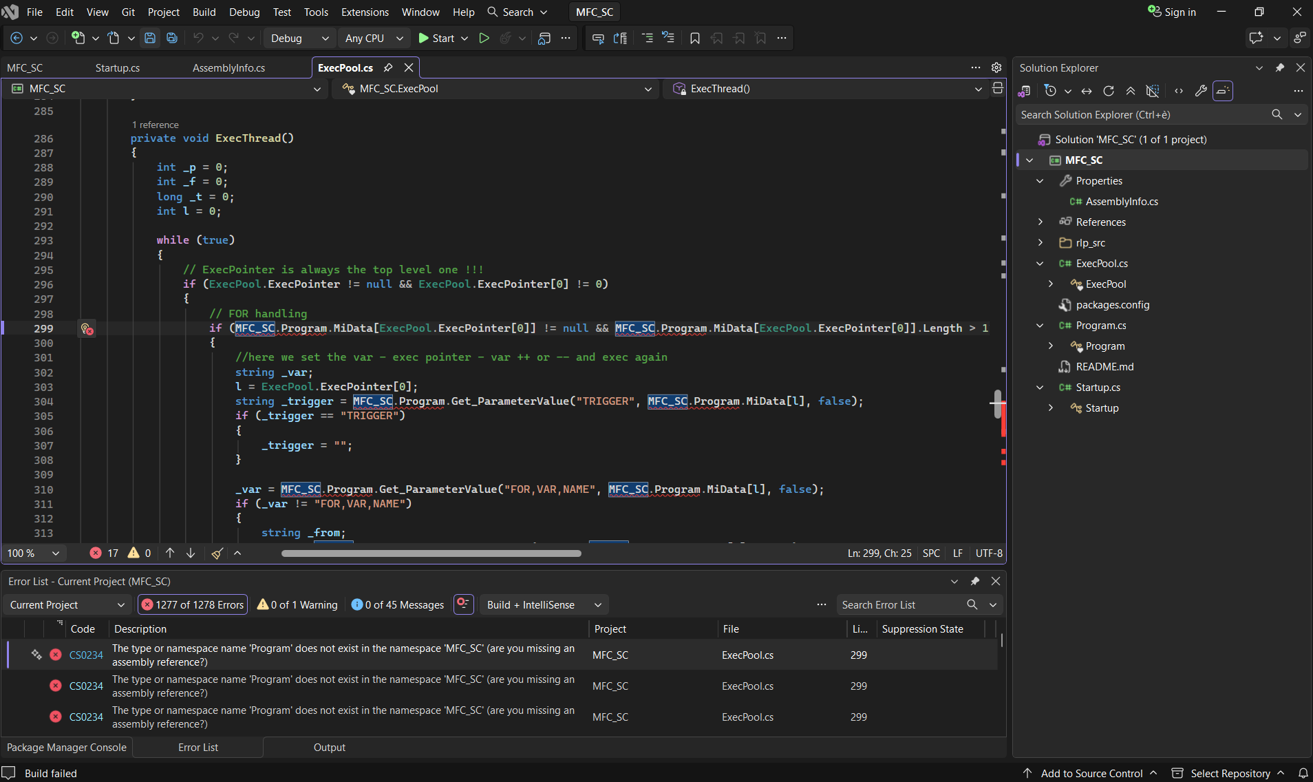

But now when I try to compile, I got plenty of error.
What is wrong with Program?

The error message looks like a namespace issue?
In the program.cs file is there a namespace statement and is the name “MFC_SC”?
