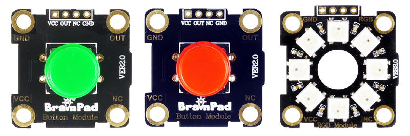

We’ll also need 2 buttons and the LED Ring modules.
