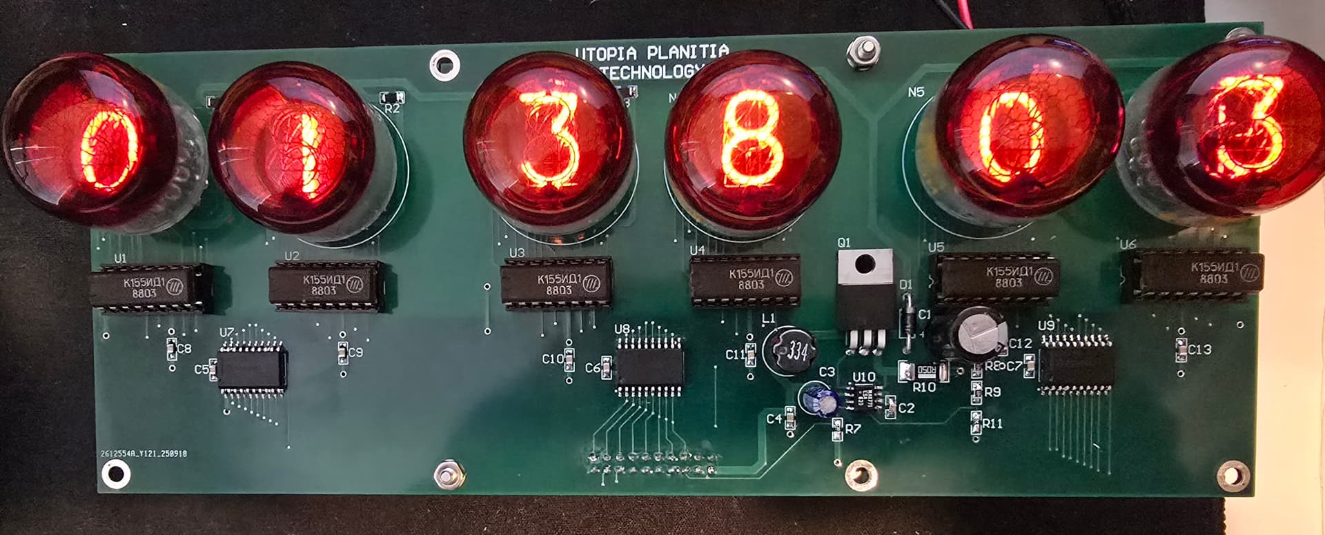

I need basic setup for this NixieClock to set the wifi credentials and Timezone etc.
