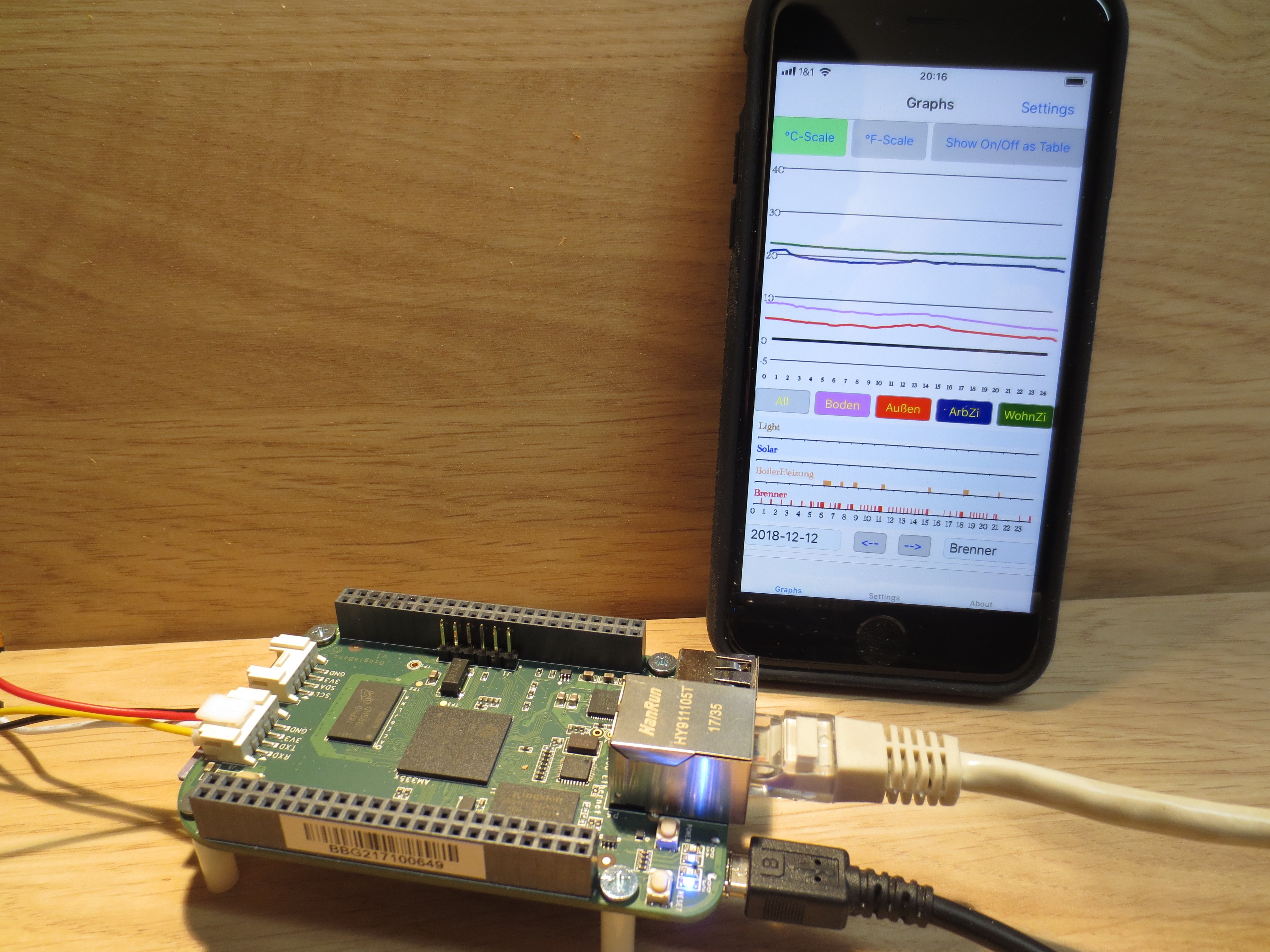

Hi, I think that you can either wait until GHI has implemented more networking functions or you could write AT-commands to the WiFi module over the serial port. If you don’t have the time to wait and want to have access to more elaborated network functions as realized in the big .NET framework and want to use ready libraries e.g. to access Azure services it might at the moment be easier to use devices like the Beaglebone with Mono. Here is an example how it can be done:
However it has to be considered that the hardware is more expensive, setting up the system is more complicated and debugging is not as comfortable as on GHI devices.

Very nice work @RoSchmi! I think one should be able to pull off the same trick with dotnet core, as there are now ARM32 versions of dotnet core. That would make the debugging setup significantly simpler, as it’s already built into VS2017. I’m working on proving this out because it would give us full compiled execution speed for dotnet code on BBB (AM3358) and RPi (A53) chips, and a consistent API from TinyCLR right up through dotnet core. And both of those (BBB and RPi) are cheaper by $10-25 and should have faster execution than the meadow interpreter-based board (being jit’d rather than interpreted). IoT on Fez is completely doable and incredibly economical, but it’s good to have a consistent software path forward into higher speeds, and TinyCLR’s alignment with Microsoft APIs opens that door.
