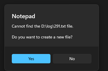

I’m looking for suggestions on how to increase the reliability of flash drives (USB sticks).
We use a USB flash drive and mount it to the FileSystem to store configuration data fetched from our backend and to temporarily store data when the internet connection is down. However, we often experience issues where our controllers (custom board with a SCM20260E) in the field are unable to mount or write to the flash drives. The typical problem seems to be corruption and after formatting the drive on a PC, it works again. Sometimes, even just inserting the drive into a PC and then remounting it to the controller makes it work again.
We flush and stop writes to the drive during a controlled restart but this doesn’t solve our reliability issue.
