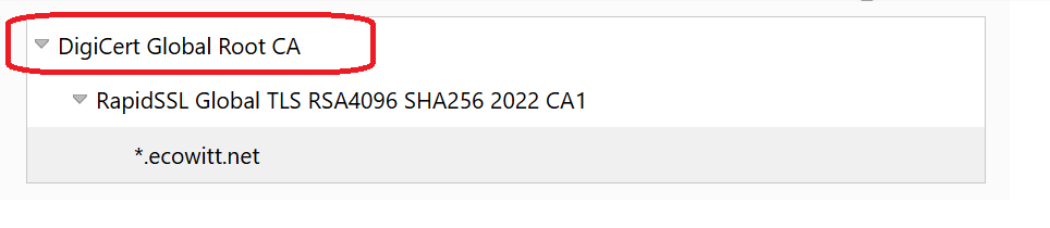

I am trying to get HTTPS working as the website doesn’t support HTTP so followed the sample for TLS and the client sample in the documentation section of the website. What I am unsure of is where I should get the cert for this. Do I get this from the website I am trying to connect to? The sample is for google.com
I exported the cert for ecowitt.net and added this to the resources and added the code to add the cert and set the HttpsAuthenCerts to the cert. I get the following from the website:

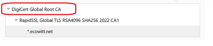

you need root, not ecowitt.net
Thanks Dat, that worked and I can download the JSON now.
