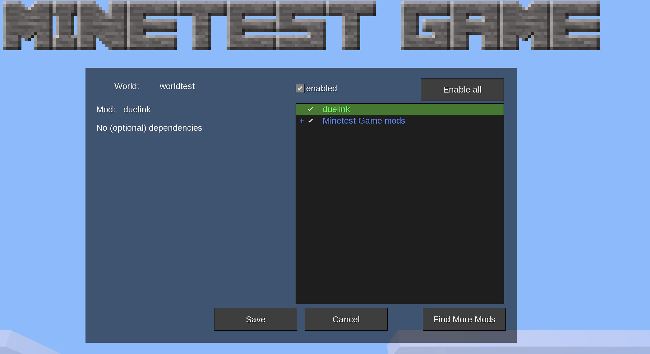

Enable the mod
  1. Open Minetest
  2. Create a new world (or edit an existing one)
  3. Go to Mods
  4. Enable the duelink mod (as shown in the image below)
