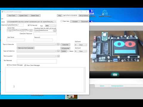

-GitHub - RoSchmi/SC20260_AWS_Test_01: Publish and Subscribe for AWS IoT MQTT on TinyCLR Board SC20260
-GitHub - RoSchmi/MQTT_Commander_WPF: Windows WPF Application using paho.mqtt.m2qtt library

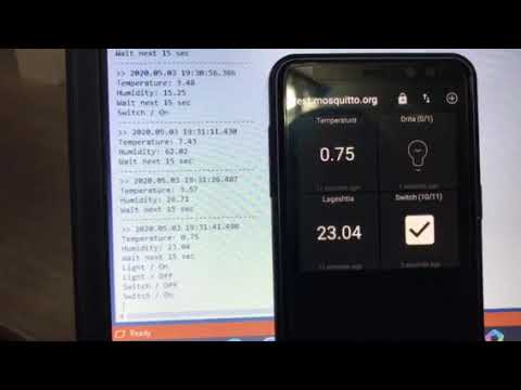

i did a little sample through ENC26J80 Click Ethernet for MQTT (via test.mosquitto.org) with MQTT Dash (Android App)
with help of @RoSchmi and big thanks to him (and of course GHI for tools)
attached source is here (small little sample)
