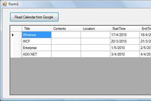

Is it possible to fetch the entries from the google calendar?
I found these tow libraries:
Can i use them for my FEZ Spider Projects?
I think i didnt understand yet, if i am able to use .net libraries for my FEZ Spider.
Maybe someone here can help me with this …
