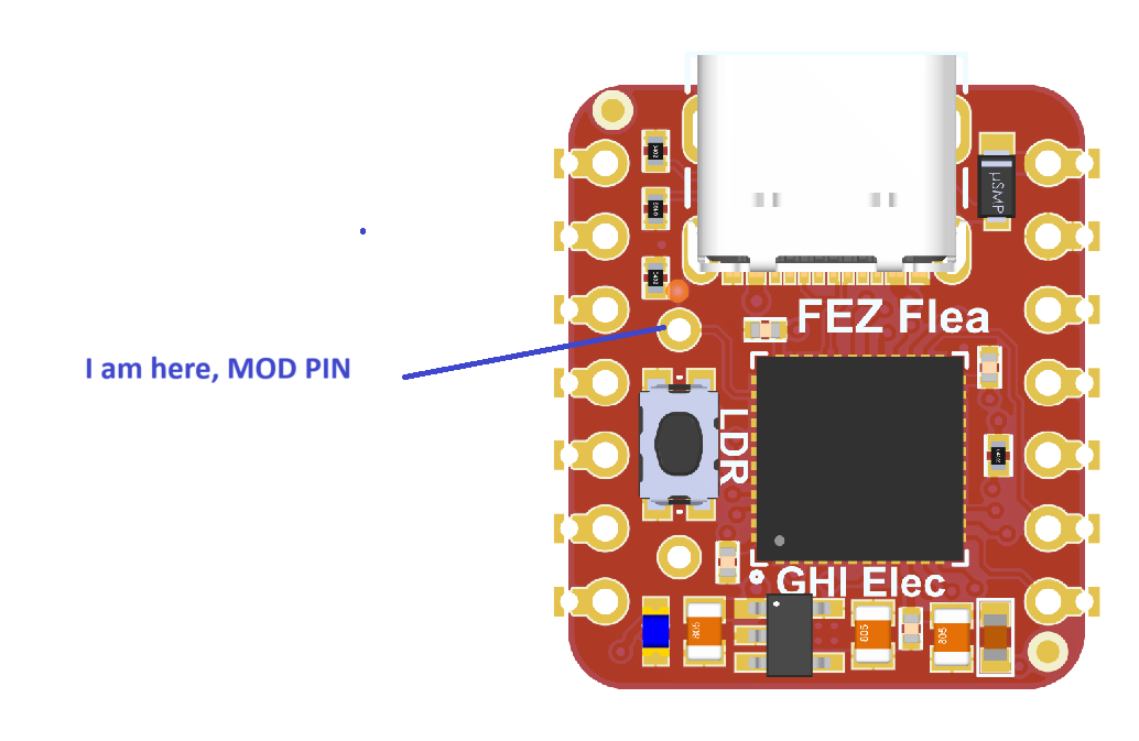

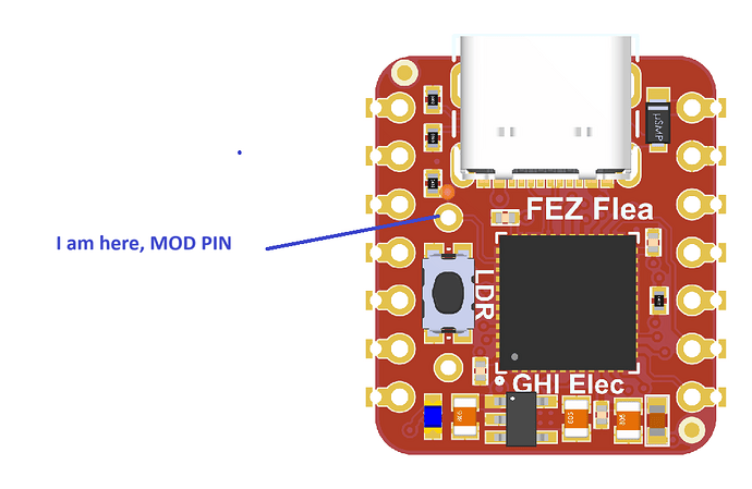

Ok, then, which pin is the MOD pin on the Fez Flea? I see it on the schematic but I don’t know where on the board it is located.
I am awsy from my Flea. The schematic shows the MOD pin to appear on TP3. Is TP3 labeled?
No, Tp3 is not labelled on the board.
