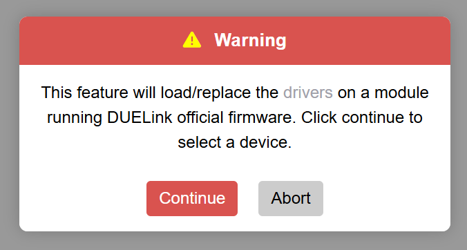

You are 100% right. There are 2 sides to this, driver update and firmware update:
For driver update, this is already supported in the firmware today. We only need to add a drop down list option to the console so you can select what device in the chain you want to update the firmware for. This window will have the option to set the device number. We should have this in a few days after the holidays.
What I would like to see however is “update all” feature that goes through all modules in the chain and update all drivers. This will come next.
