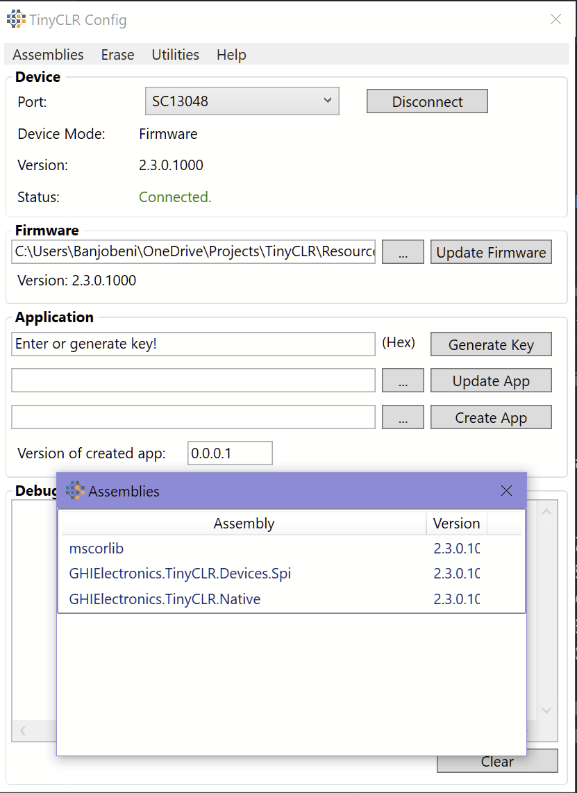

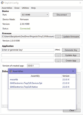

Consequently, this matches the listed in TinyCLR Config after deployment:
So the GHIElectronics.TinyCLR.Devices.Gpio is missing although it is said to have been deployed to the device.

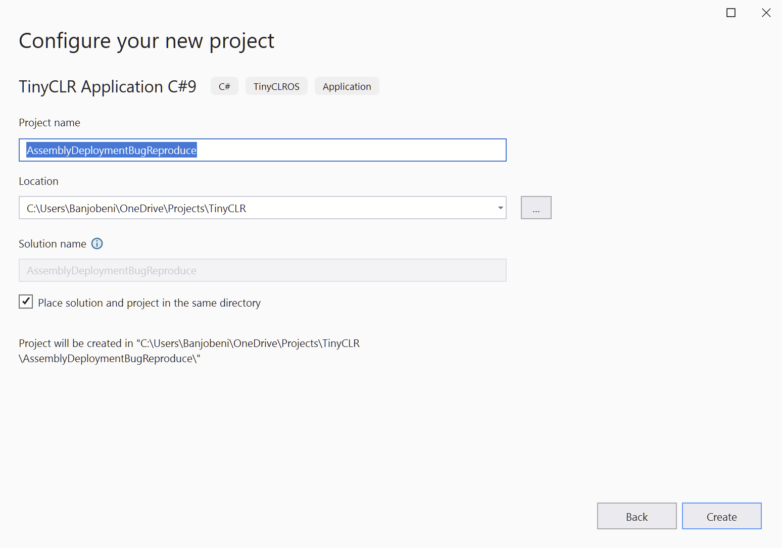

Create new Visual Studio project (using VS Extensions “TinyCLR OS Project” v2.3.0.1000")
