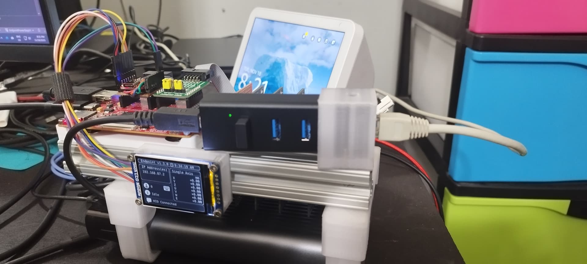

I have a USB hub with Ethernet on the endpoint host port. When the device is plugged in at boot, it is detected, and the interface comes up. When it is not, the interface never comes up. It also does not come back up if I unplug the USB and plug it back in. Any thoughts as to what I’m doing wrong?
Ok. I think I figured out what’s happening in the background. If you call network.Enable() before a device is plugged in, NetworkController will run dhcpcd in vain. It won’t get an ip and nothing will recheck the system later when a device is plugged in.
