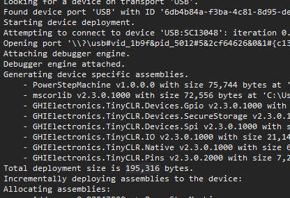

I’ve begun stuffing the dSpin driver, the GCode parser and the machine contexts into a FezFlea, porting back TinyCLR OS from full .NET 8!
There are 28,940 bytes left in the deployment area and I still have to add CAN bus and config stuff.
