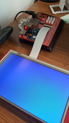

I have Fez Cobra 1.3 and I know it is old. But I have to make a prototip for a thing. So I wanted to use it then I connected board to pc and I deploy my code to board, it works cause I can see pin codes at Visual Studio debug console when I press buttons. Just I couldn’t get display.
Thanks for reply brett. But It even was working on netmf 4.0. I just dont remember how was it works. I think it doesnt work because of power. Could it be?
if you think it might be power then you want to NOT run it off USB. Using a 12v minimum to (I think) 30v DC input is appropriate. Displays take a lot of juice so use a 1A capable regulated supply would be another good starting point
Edit: I agree with Dave that it looks like a LCD timing setup
