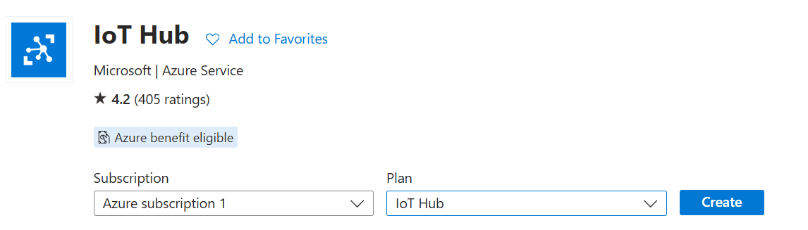

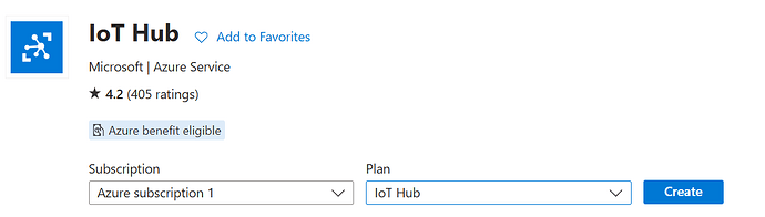

Start by visiting your Azure portal and add an IoT Hub.

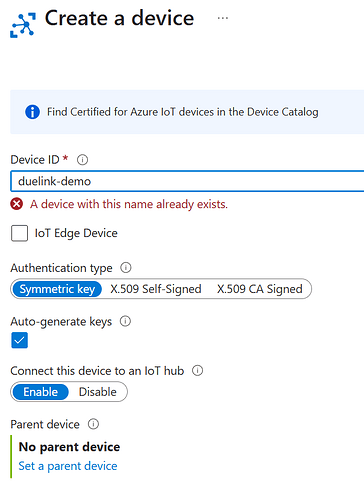

You can now start adding devices to the hub.

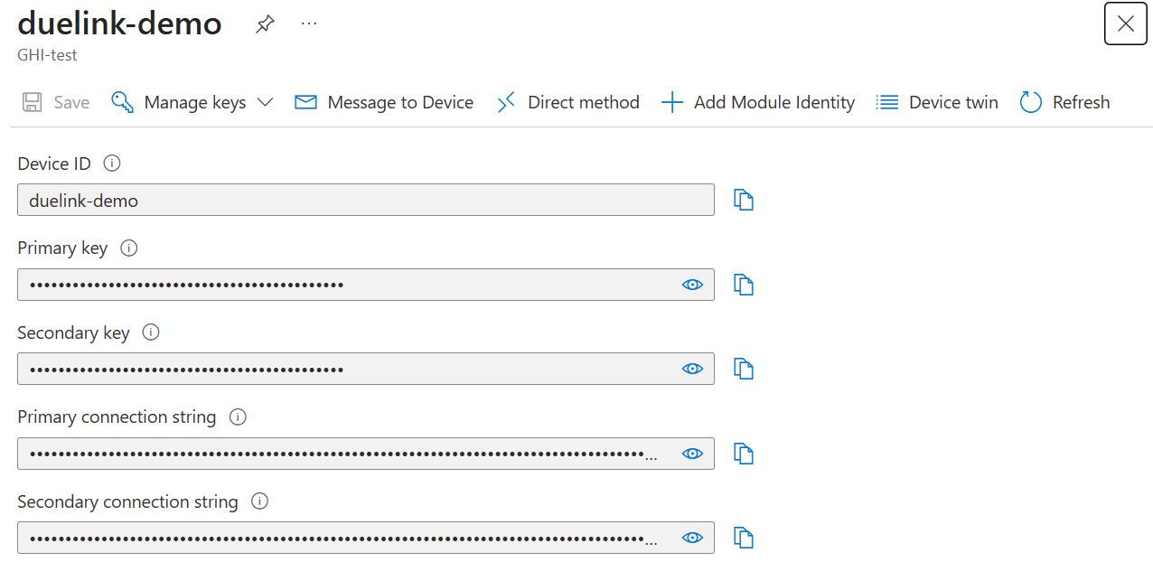

We now have a device with secret keys and complete connection strings.

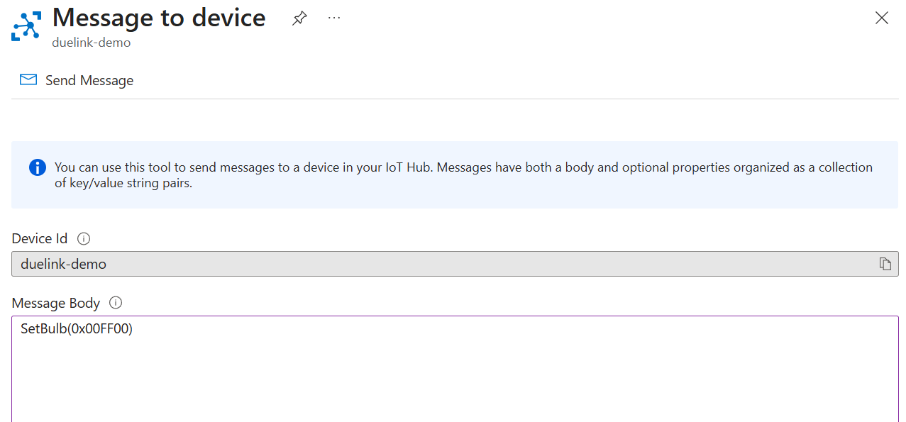

Connecting to this device is easily done via the Azure provided libraries. Plus for testing, the IoT Hub’s portal includes “Messages to Device”. We will use this in a minute

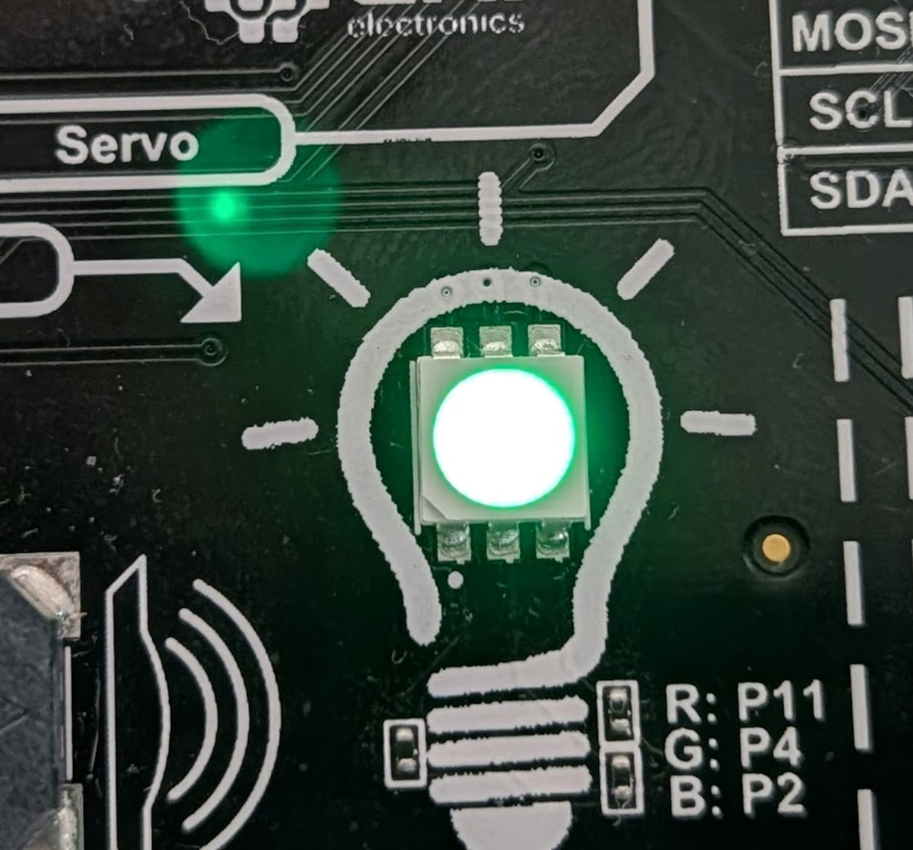

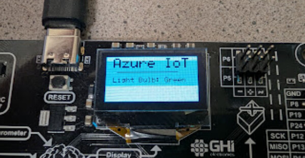

Go back to the portal and sendSetBulb(0x00FF00). This will change the bulb to Green.

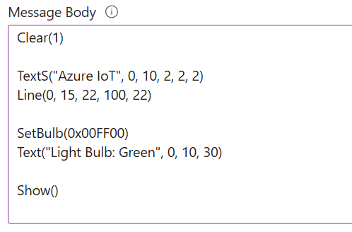

We can also test multi commands.
And we have text!
