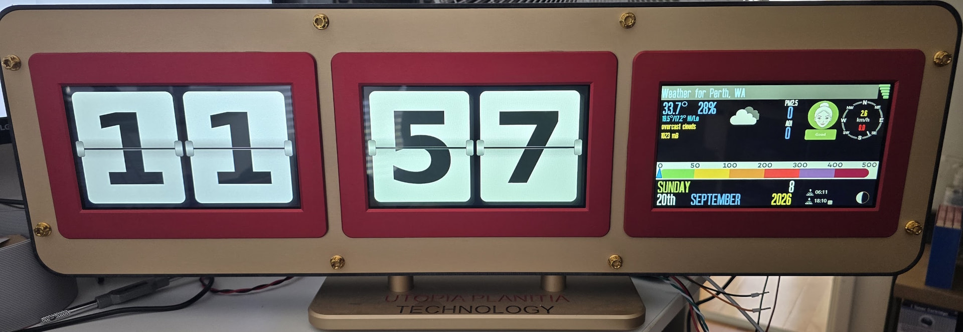

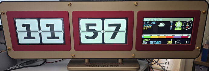

Meanwhile, here is what I have so far. The flip images were created with Claude AI as well as the SITcore flip animation code. Pretty impressive but took a few revisions to fix a bunch of memory leaks.
The hardware is based on the SCM20260D modules. The LCD is high brightness modules from Newhaven Display and are 1024x600. There are 3 in total and interconnected via CAN bus. The display on the right has WiFi and Lora and also connects to my weather station for local data and Open Weather for the forecast. The PM2.5 is via Lora from a sensor in my garden.
The LED bezels are aluminium anodised red and the front panel is also aluminium anodised in champagne. The main body is ABS. All mechanical parts were made by JLC PCB.

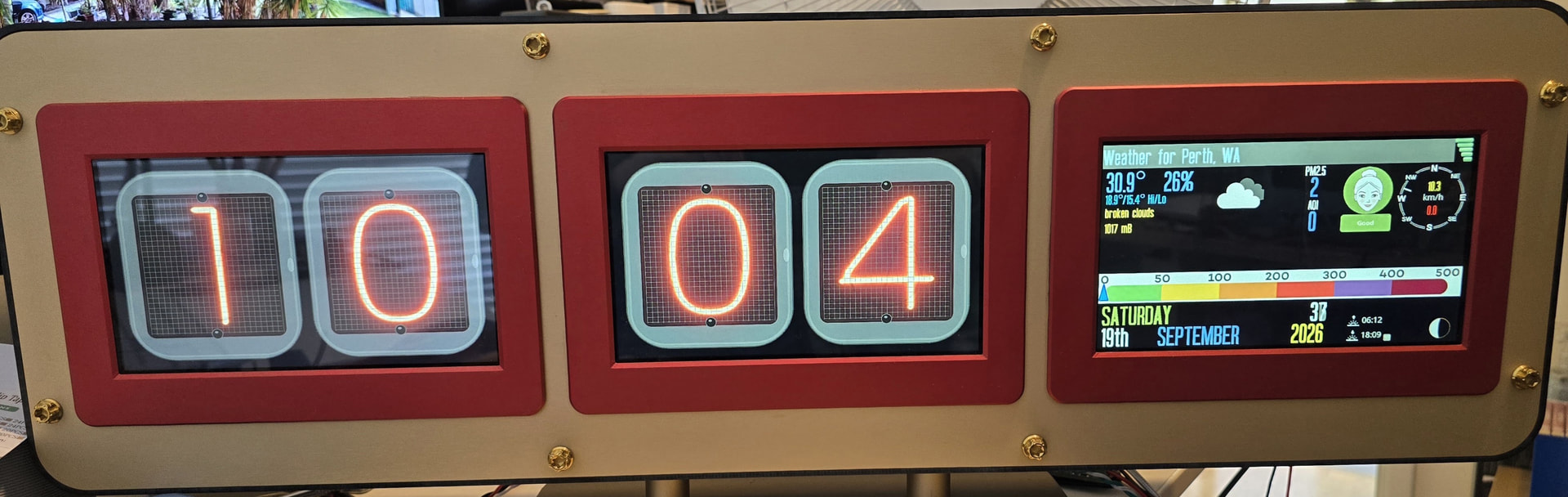

I am adding additional displays and currently adding a Nixie (Claude created them) and a blue glowing seven segment display.
Here is the early version of the Nixie displays. Still refining this to add the wire frames of unlit digits.

Hey Gus, Claude was able to use a Stretch.Fill to create the flip on the clock. It looks the business now.
