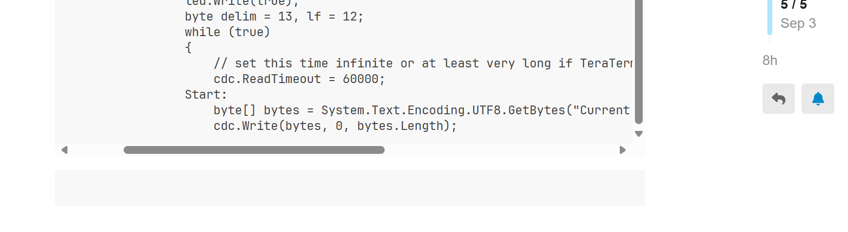

                                    byte[] bytes = System.Text.Encoding.UTF8.GetBytes("Current ADS time is " + DateTime.Now.ToString() + "\r\n");
                                    cdc.Write(bytes, 0, bytes.Length);

Found the cause of this problem and perhaps it can help someone else because it turned out that wasn’t a dirver problem or anything else in the hardware, nor was it specific to older FEZ hardware like the Panda II. It was how the software was designed.
The software provided the user with one of two options to power the device. One used an external battery for field deployment and the other was through the USB connection providing both power as well as the ability to communicate to download collected data. There were two cables provided but only one was supposed to be used at a time and while this was explained in the user manual there was no software check to detect if both cables were plugged in.
So if the user plugged in both cables the beginning code section that was checking to see if USB was active might have already executed and the code moved on to collecting data. This was verified when I met with the users and was showing them the process when they asked, “Don’t you have to plug in both cables?”
Bottom line is the problem wasn’t the user nor the hardware. It was me not designing the code to be failsafe and allowing a single point of failure caused by using both cables instead of just one. Originally it seemed like a clever way to automatically determine how the user wanted to use the device. Unfortunately it did not anticipate what would happen if both cables were used simultaneously which in hindsight was certainly possible.
