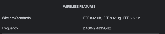

The TL-WN725N is 2.4Ghz only from what I read. Is your router maybe using the same SSID for 2.4 and 5GHz with automatic band switching turned on? Just for giggles, you might try turning off 5GHz or using different SSIDs for the two bands and join the Endpoint to the 2.4GHz SSID.

@mcalsyn, apologies for the delayed reply. In my case it was a faulty SD card, I have had no issues since replacing the card. I am connecting to a TP-Link Router and have had success if connecting to either a 2.4GHz only SSID or to an automatic band switching SSID. I am using USB C and have monitored the current draw when using Wi-Fi and have observed a maximum of 0.29 A. Thanks.
