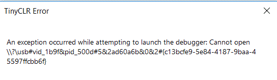

I receive
Assemblies deployed.There are 362,580 bytes left in the deployment area.
Restarting interpreter.
Attaching to device.
Waiting for device to initialize.

I forgot to show you this. Received from VS2017 at times’’
