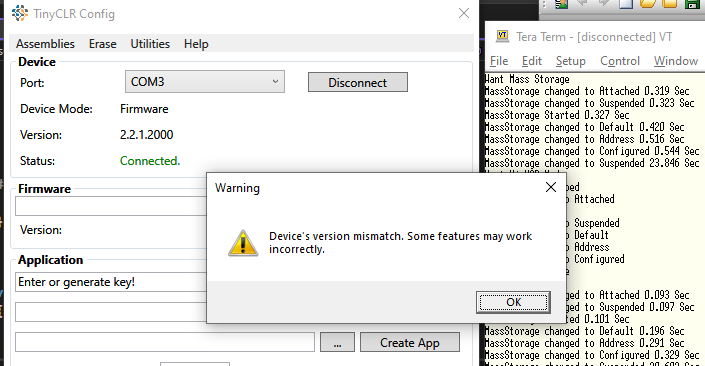

This morning I installed 2.2.1.2000 and ran through the tests again. The PC that was taking over a minute to bring up the drive in Explorer now shows it almost immediately, big improvement, thanks!
Loss of “Eject”
One difference between the two versions, under 2.2.1.1000 if you tried to “Eject” a drive from Explorer it would change the device to “Suspended” state, and Windows would lock the drive to allow it to be removed. You could use the “Suspend” to change modes on the device.
Under 2.2.1.2000 you don’t get the “Suspend” state on Eject (although you still do if you unplug it), and Windows puts up a dialog saying it was unable to eject the device.
