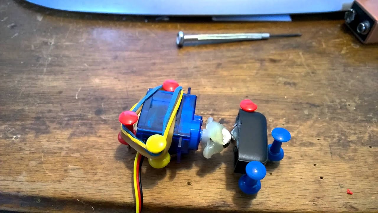

Here is an Idea Why not use two Disk like Magnets one on each end and use a Servo to turn one magnet 360 degrees or close to repel the other magnet and turn the servo the opposite way and it will suck it in… and to release it just apply power… see the attached pictures of a really dirty demo with green wires, an MS Pen and a small servo…
stick all that above in a nice little box and call it an On Power Magnet Release Switch…
Btw now you owe me a Microsoft Pen, since I broke mine to do the demo for you :), and punched a few holes on my desk…
Edit: you can also use a regular motor instead of a servo to turn the magnet and a rubber band that would get twisted when power is applied, this way when no power the rubber band will untwist causing the motor to turn back to original position allowing the magnets to stick…
This would make it into a nice invention wouldn’t it

nice hacking there Jay !
Great invention just there ![]()

now I have an excuse to buy a 3D printer… I could have just created a nice little tiny box to hold it all in a permanent seal enclosure…
maybe version 2.0 …
I wouldn’t call that experience more like a mess ![]()
cheers and good luck ![]()
Jay…
@ Jay Jay - I would call it “a complex order of cleanliness”

Here is an Idea Why not use two Disk like Magnets one on each end and use a Servo to turn one magnet 360 degrees or close to repel the other magnet and turn the servo the opposite way and it will suck it in… and to release it just apply power…[/quote]

my version will cost way less than $5 ![]()
here is version 2 a little better to see in action…
Servos cost: http://www.dx.com/p/towerpro-sg90-9g-mini-servo-with-accessories-12859#.U_d2rdh0yUk can go as low as $0.50 if bought in volume

Design a nice way to package all that using AutoCad and send it out for mass production, Priceless ![]()
