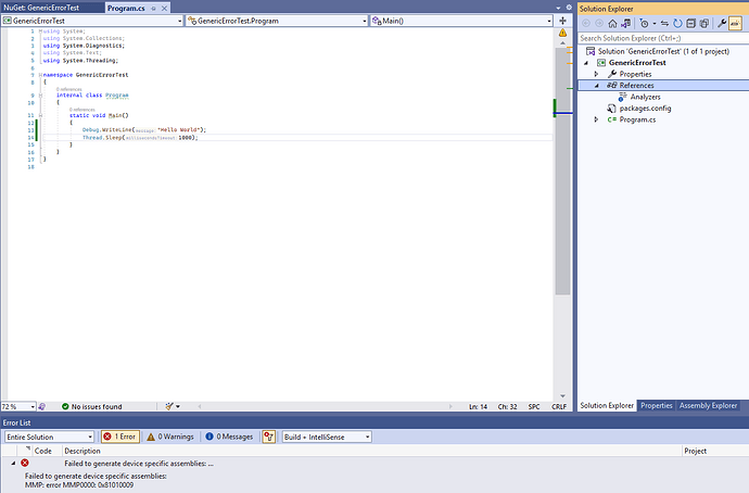

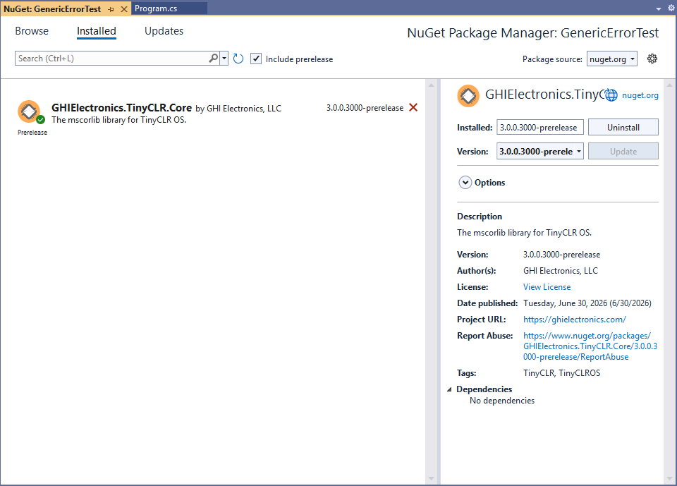

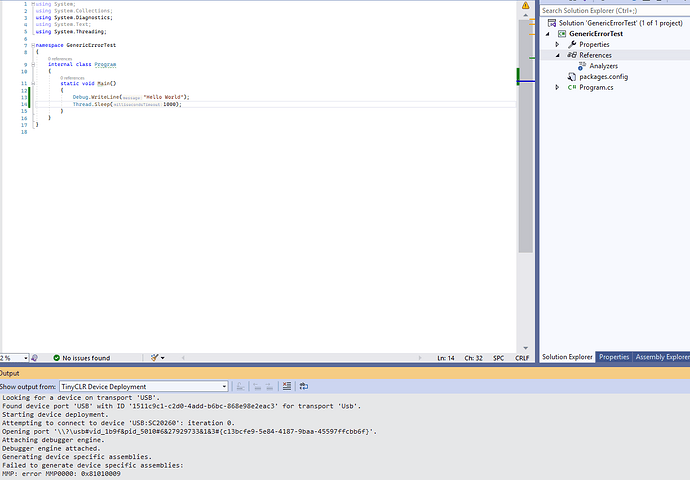

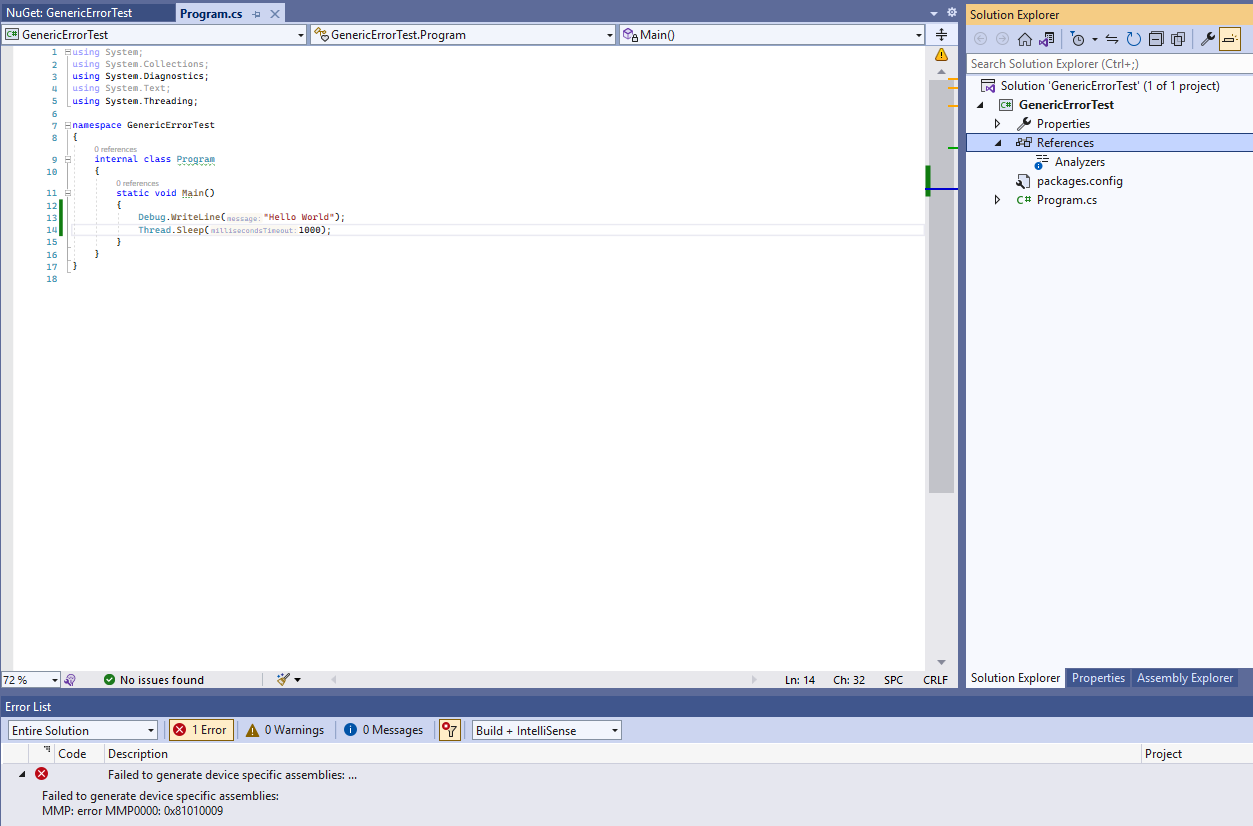

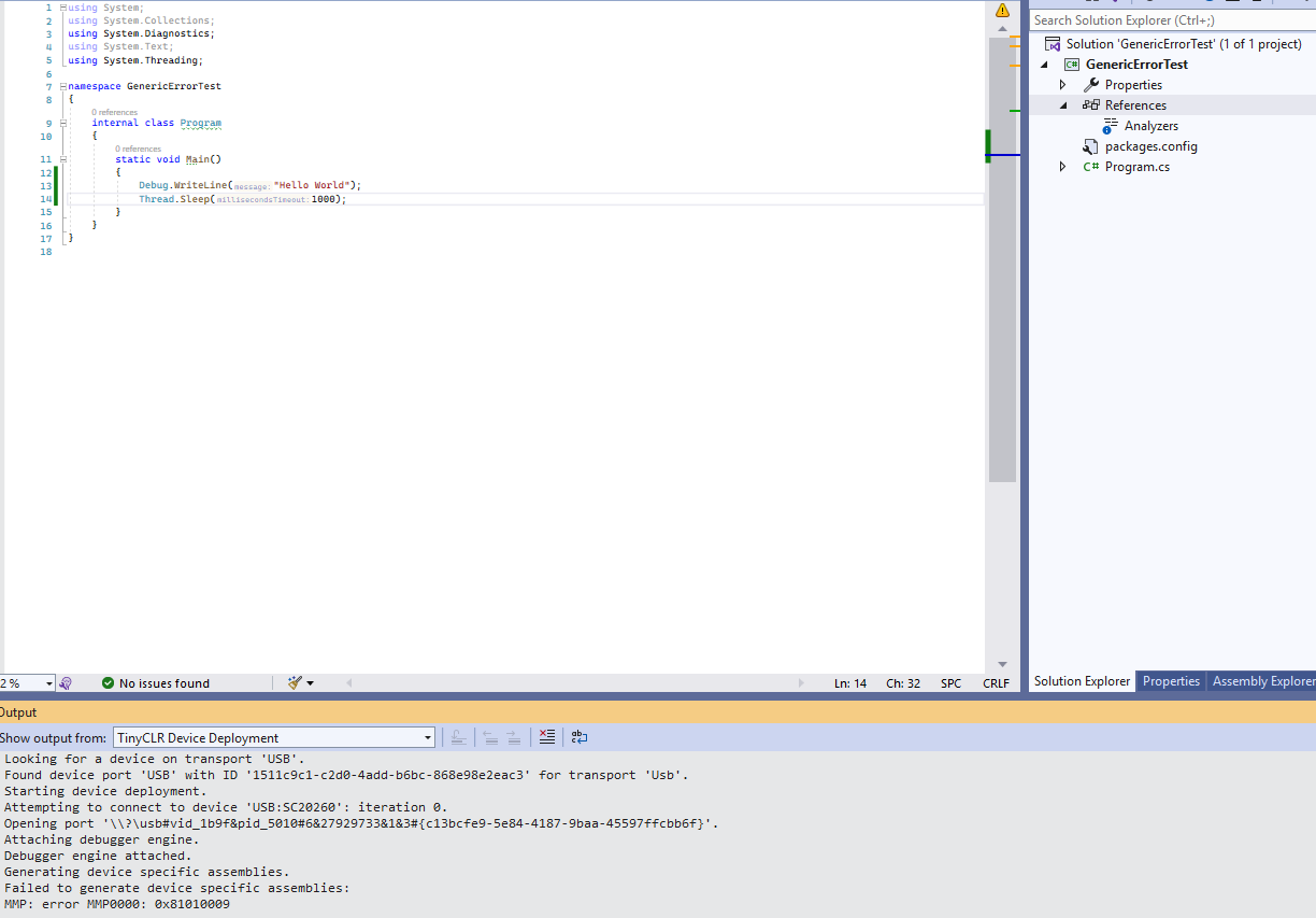

@Dat_Tran I sent in a large amount of information via email, however I’ll also post the images and background information here as well in case anyone else is experiencing the same issue.
The project simply writes “Hello World” to the debug line every second. The project builds just fine, but generates the error when attempting to deploy to a SCM20260E processor which is running “sitcore-sc20-firmware-v3.0.0.2000.ghi”. I also attached screenshots showing the only .cs file in the project, the error code, the only reference is the TinyCLR Core version 3.0.0.3000, the error shown both in the error list and output, and the TinyCLR Config tool showing that the processor is running firmware version 3.0.0.2000.
The only peculiarity is that I am forced to use an older version of the TinyCLR Config tool, since both versions 3.0.0.2000 and 3.0.0.3000 instantly close when I try to open them. The exit code presented is hard to see since the command window closes so quickly, but slowing down a recording it reads as 0xffffffff. Therefore I used my older TinyCLR Config tool version 2.3.0.1000 to install firmware version 3.0.0.2000 on my SCM20260E. Hopefully that does not cause any issues with deploying the application, but I thought you would appreciate knowing about that issue as well.

Also, update firmware is not enough. The error comes from extension. Did you update the VS extension?
@Dat_Tran Apologies, I sent it to Gus and got mixed up with who I sent it to since we had been messaging on the forum. Forwarding it to you now.
I don’t believe that I updated the extension since it wasn’t on “The short version” instructions here:
I’ll update it and let you know if that fixes the issue.
That was the issue. I updated the extension and now everything is working. Apologies for forgetting a simple step. Might be worth adding to the tutorial for migrating from v2 to v3 in order to ensure that it makes it onto users’ mental checklist.

Ran the tests:
Results of test 1:
Trying to step over the line
var entry = Dns.GetHostEntry(“ghielectronics.com”);
results in the following error:
#### Exception System.InvalidOperationException - CLR_E_INVALID_OPERATION (1) ####
#### Message:
#### GHIElectronics.TinyCLR.Devices.Network.Provider.NetworkControllerApiWrapper::GetHostByName [IP: 0000] ####
#### System.Net.Dns::GetHostEntry [IP: 0024] ####
#### GHI_Framework.EthernetController::DoTestDnsTemp [IP: 0008] ####
#### JX200Pro.MainThread::Main [IP: 00a8] ####
Exception thrown: ‘System.InvalidOperationException’ in GHIElectronics.TinyCLR.Devices.Network.dll
DNS threw (expected): Exception was thrown: System.InvalidOperationException
Results of test 2:
Works on my PC despite throwing an exception on TinyCLR
I’ll make a small project that reproduces the issue and send it to you.
